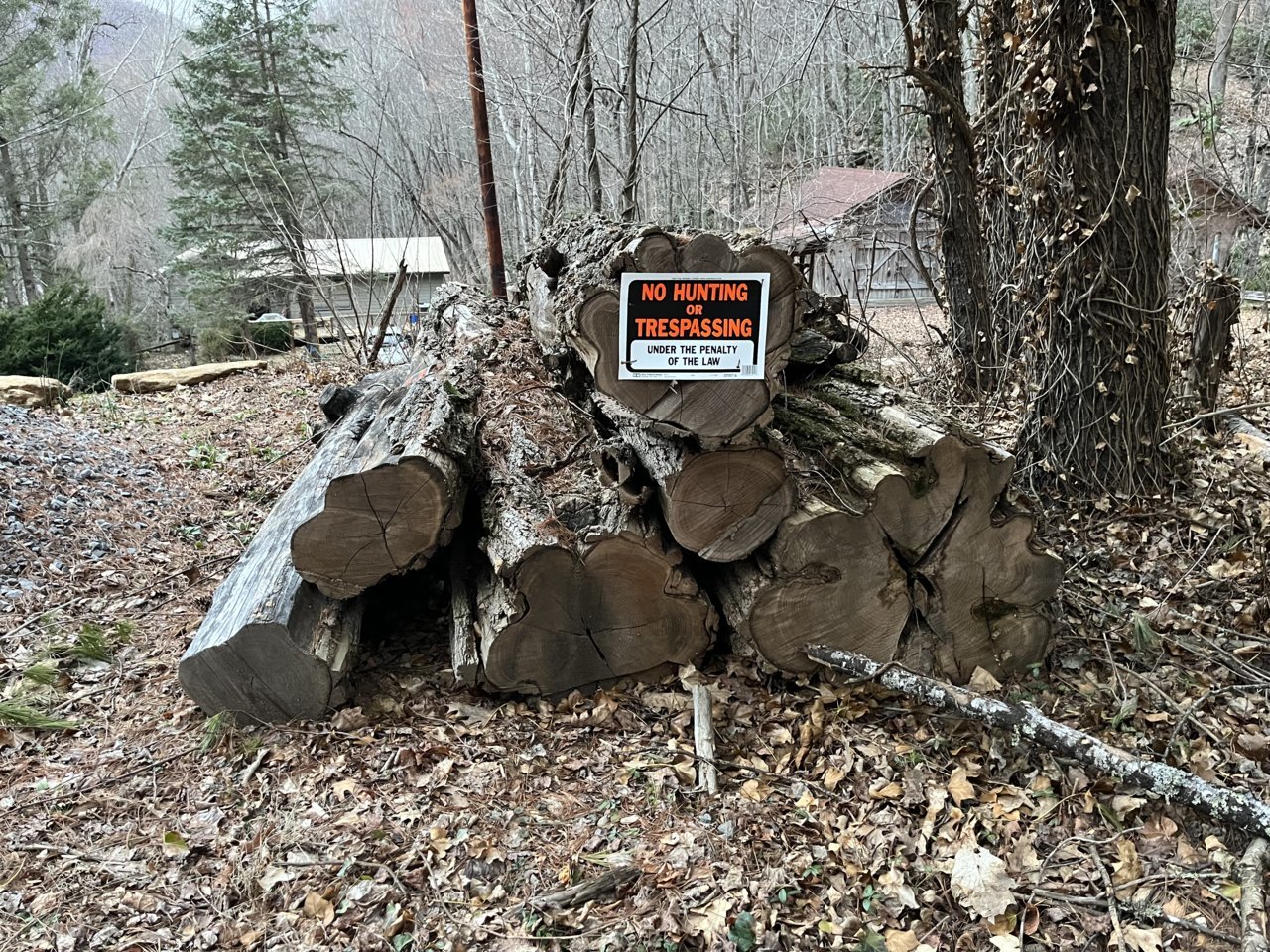

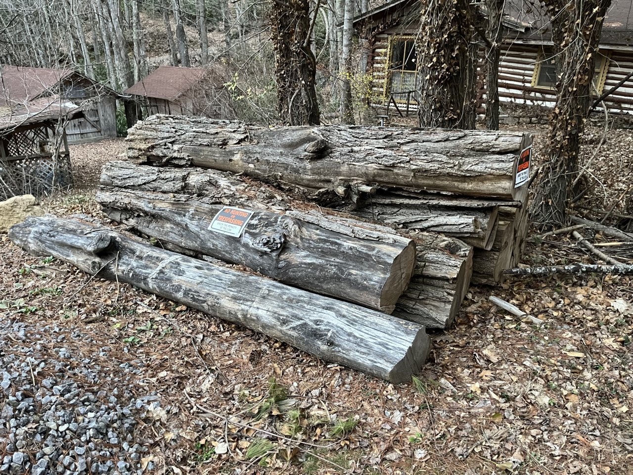

    Who wants to help me with this. I wanna saw some rough benches out of it. Large squares or rectangles to be exact.

    Don't do it, it's a trap. He'll get you for trespassing... under the penalty of law.

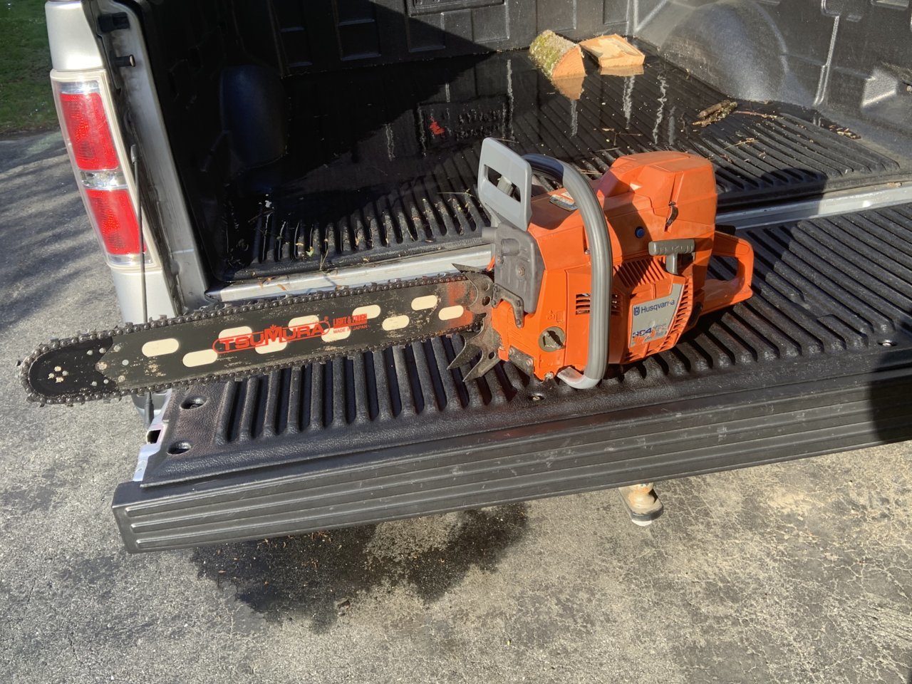

    Ported 395. It was a 394 but the cylinder was cracked. FC07796F-46A6-4C38-8F9D-43AD6238F7E7.jpg

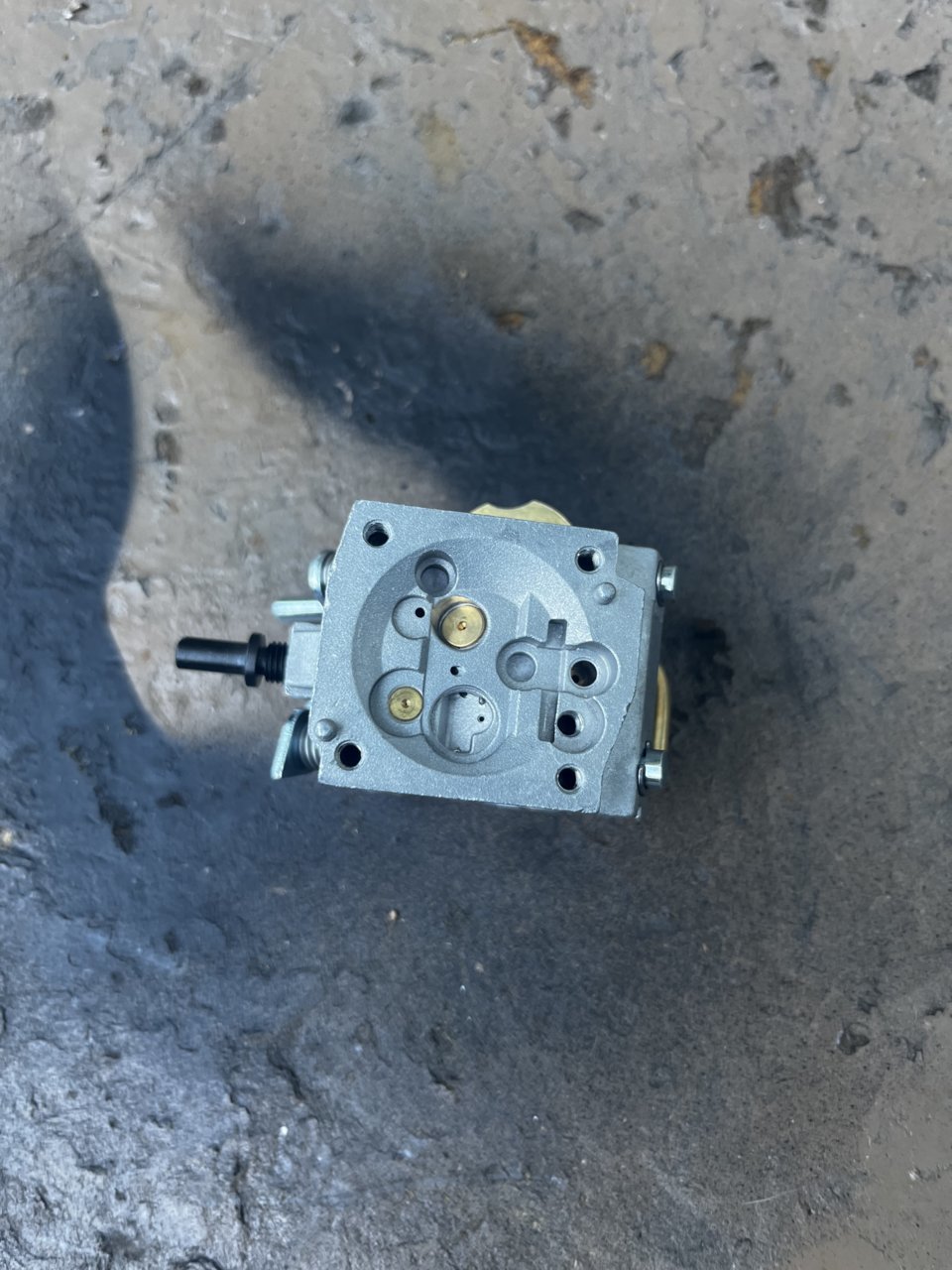

    I have some videos of me competing with my hot saws. But no practice stuff. Particularly with methanol, so much stuff is going on I don’t have time to mess with the cell. As afterwards, you have to flush it with GAS. I take my time and wick as much of the meth/nitro with paper towels rolled up. Once I soaked up most of it in the tank, it’s time to flush with gas.
    I do have GREAT news. Now that I know more about carb flow and how to improve their performance, I was able to check with Cody and no one has tried fixing it for him.
    Long story short, I modded a Stihl 044 for him 7/8 years ago. Two piece head build. The carb could never settle the high rpm’s. That tells me (now) that it’s running lean on a maxed carb. So I’ll be modifying the small ports that feed the L and H circuits. More fuel will get him to be able to tune the saw when needed. And the performance level will rise even more. I’m pinche stoked!

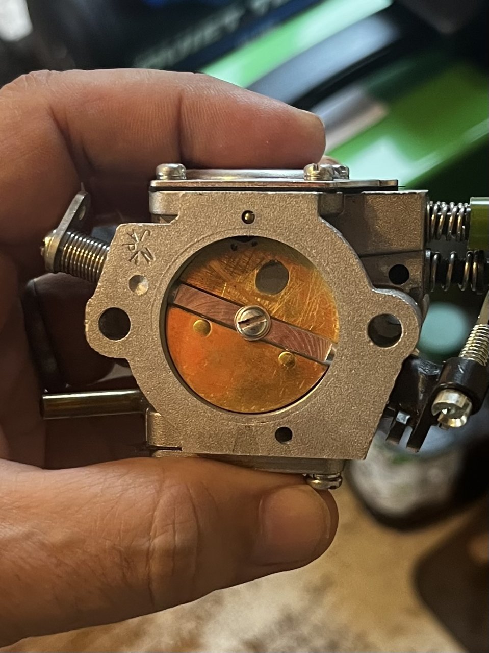

    BTW, those of you with 3120’s, if you have a lathe, you can bore the throttle plate to accept the choke plate. Note scribed line on the stock plate.
    I’m going to attempt the same on the 044 in the future IF this present mod works.
