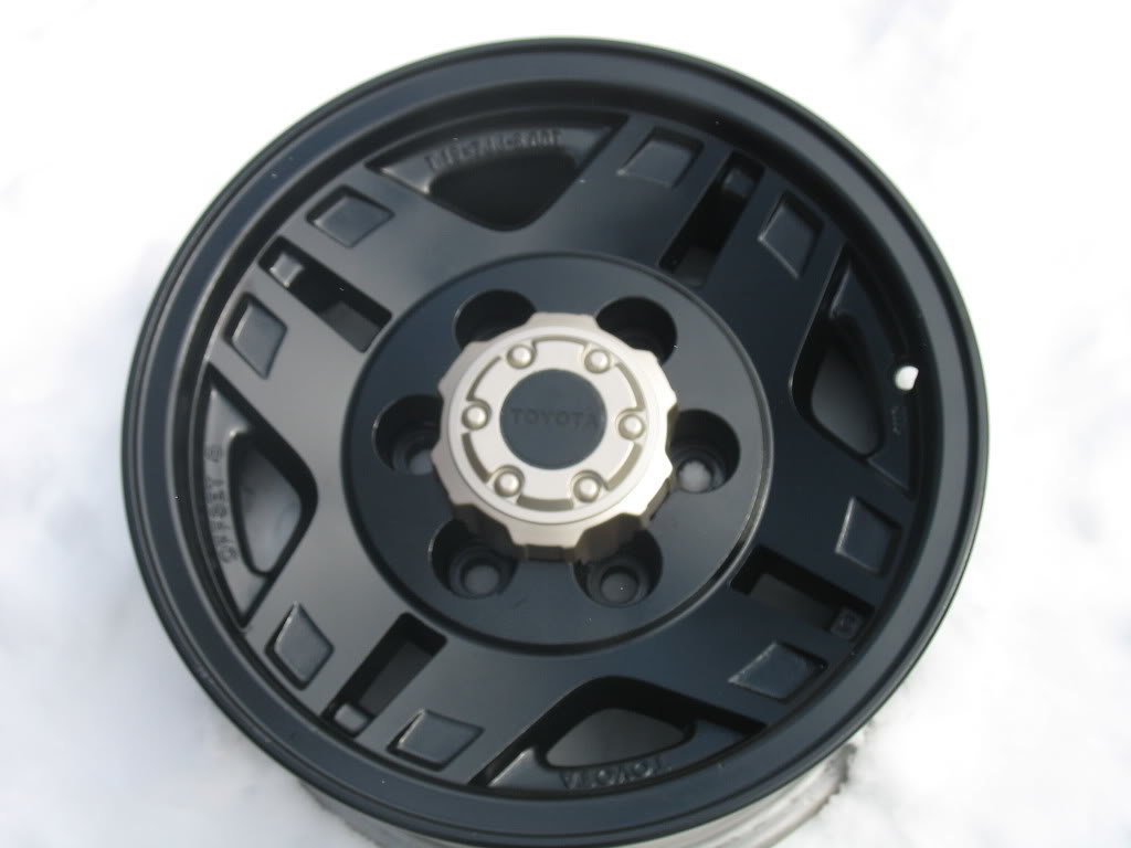

    Blacked out badges-rims OME lift with 881's & dakar pacs, summer tires=BFG 31x10.5x15 on 93 4runner rims,winter= 265 75 16 DURATRACS on stock steelies,Flowmaster exhaust, deck plate mod, ARB front bumper
    I sandblasted these old 4runner rims, cleaned with simplegreen, primed with self-etching primer and painted with duplicolor wheel paint
    they have held up well
