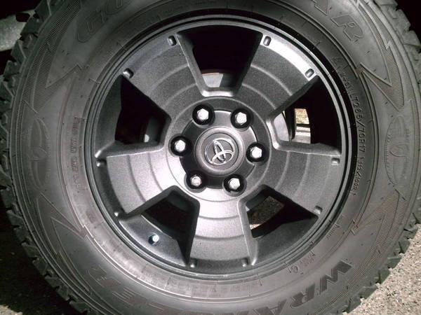

    I used this stuff...
    http://www.amazon.com/gp/product/B002O0OTTC?ie=UTF8&force-full-site=1
    Bought the wheels on CL for $125. They were already painted black, but it was a bad job. I had them sand blasted for $20 a wheel, used a rattle can self etching primer, then had my friend shoot them with the paint I mentioned above(no clear needed). I've had them on the truck for over 2,000 miles and it's holding up great.
  10. Mar 4, 2012 at 10:13 AM
    #50
    txtuffluck
    txtuffluck Well-Known Member
    Apr 25, 2011
    #55543
    249
    Johnny
    Central Texas
    07 TRD OR, V6 4X4
    The white mark on the bottom is on the inside of the wheel and is adhesive/paper from a label that was there. Any little marks that may look like scratches or chips are really just some spots of dirt.
    I ordered black Gorilla lugs through Discount Tire for $2 per lug nut.
    I've also had tires installed, removed, and a new set installed. Discount Tire didn't scratch or harm the paint at all...not sure if that's a reflection of the care they took during installs/removal, or if it's because the paint is so durable, maybe/probably both!?
