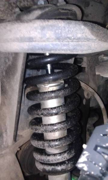

    Got the 881's installed the other day. Really liking them so far. Definetly a smoother ride. I did end up dropping the 5100's down to the lowest setting, and still got about another inch of lift. Just about 2" total. We'll have to see if they settle a little, my truck is just about level currently.
    Take a look at the old coils, think they need replacement...
    New coils installed:
    New coils look a little better, take a look at the steeper control arm angle
    I'll try to post some pics of the new stance tomorrow.
