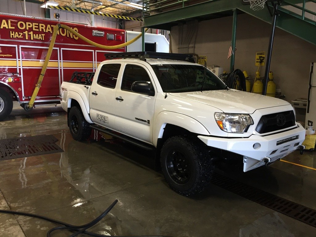

    I'm happy with mine
    46CF88CC-4D51-4C63-B0A6-8F21779E117C_zps_9d8ccbf39921d9cdae4281cf68d2ef39001dc6ff.jpg
    Color matched the rear bumper and taillights also

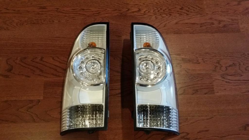

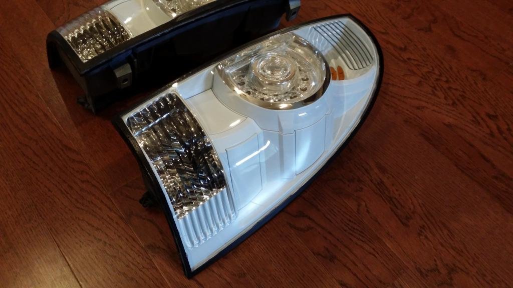

    How hard was it to do the taillights? I like the painted over reflectors, but have been painstakingly searching for clear to no avail. Any leads?

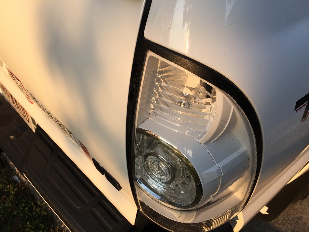

    Not so hard as it is time consuming and just working up the nerve to cut the lens off. You can't bake the taillights like you can the headlights for the BHLM. You have to use a dremel tool with a small cut off wheel. There is a small gap between the lens and housing. You have to cut about 1/4 inch in between the lens and housing all the way around the taillight. That is part of the time consuming part. Then once the lens is removed you have to tape off everything that you don't want painted. Prime, let dry, sand, paint, let dry, paint again, let dry, etc... Once you get the color you want you have to epoxy the lens back on the housing. Let dry for 24 hrs. Then seal the gap between the lens and housing no less than 3 times with a 24hr curing time in between. After that you have to tape off the entire outside lens with the exception of about 1/4 inch around the edge and paint that area black to cover up any glue / scratch marks left from the cutting wheel. Then your done. It's about a 3-4 day process.
    What they look like done. I've since replaced the amber bulb with a LED amber bulb so it doesn't show when not lit.
