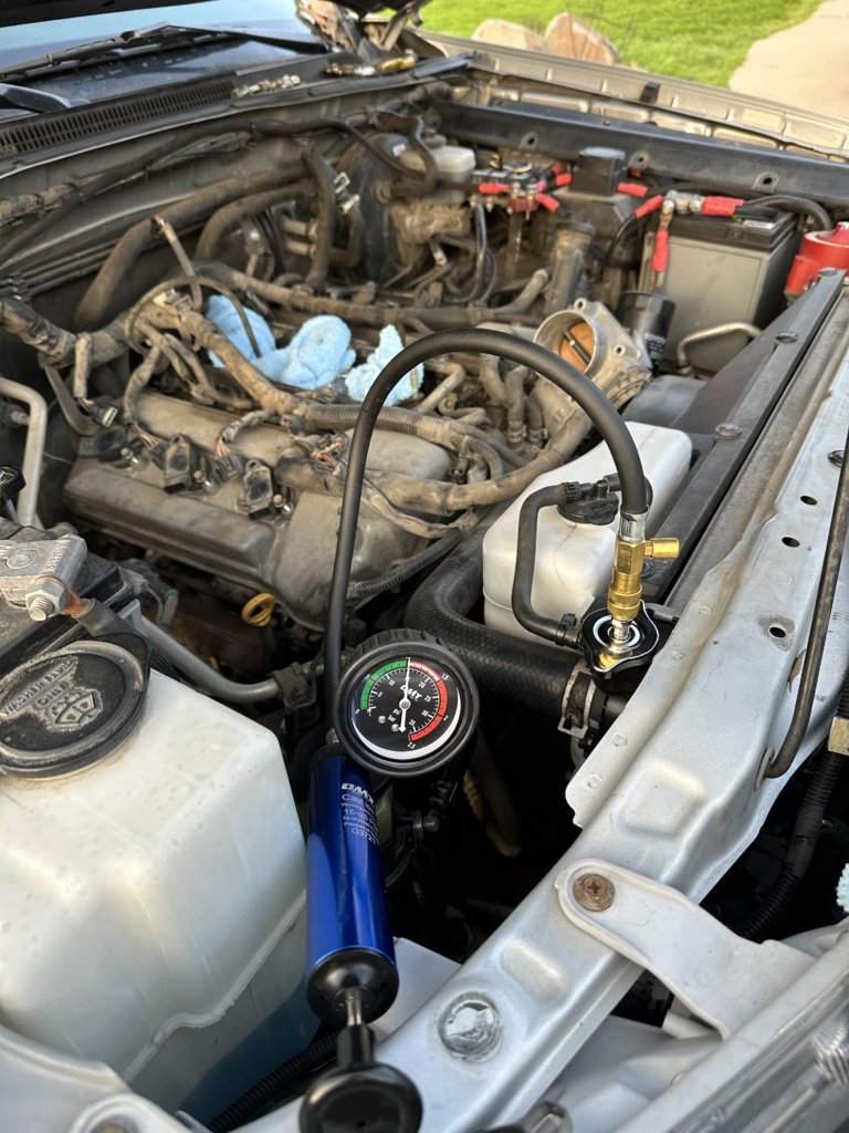

    I ended up going with this one and it worked great….and confirmed my HG leak :/IMG_8565.jpg

    At least now you know. What’s next?

    Still trying to figure that one out. Motor has 263k. Really don’t wanna spend 4k plus for a new engine. Rarely drive the truck anymore anyways
