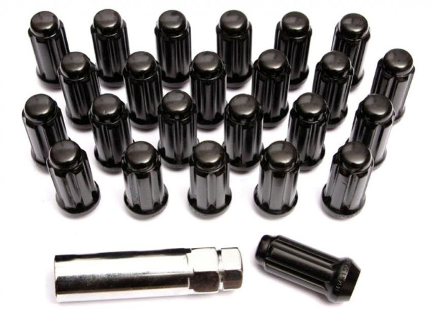

    Well even more reading and i think the problem my also be because of my lugnuts. They installed non shanked lugnuts. The ones in the pics are what they installed.Would it be worth it to buy shanked?

    That shouldn't cause a balance problem, but you should definitely running extended thread lugs with aftermarket wheels.

    If your thread engagement is less than the diameter of the stud, you are at risk of losing a wheel.
