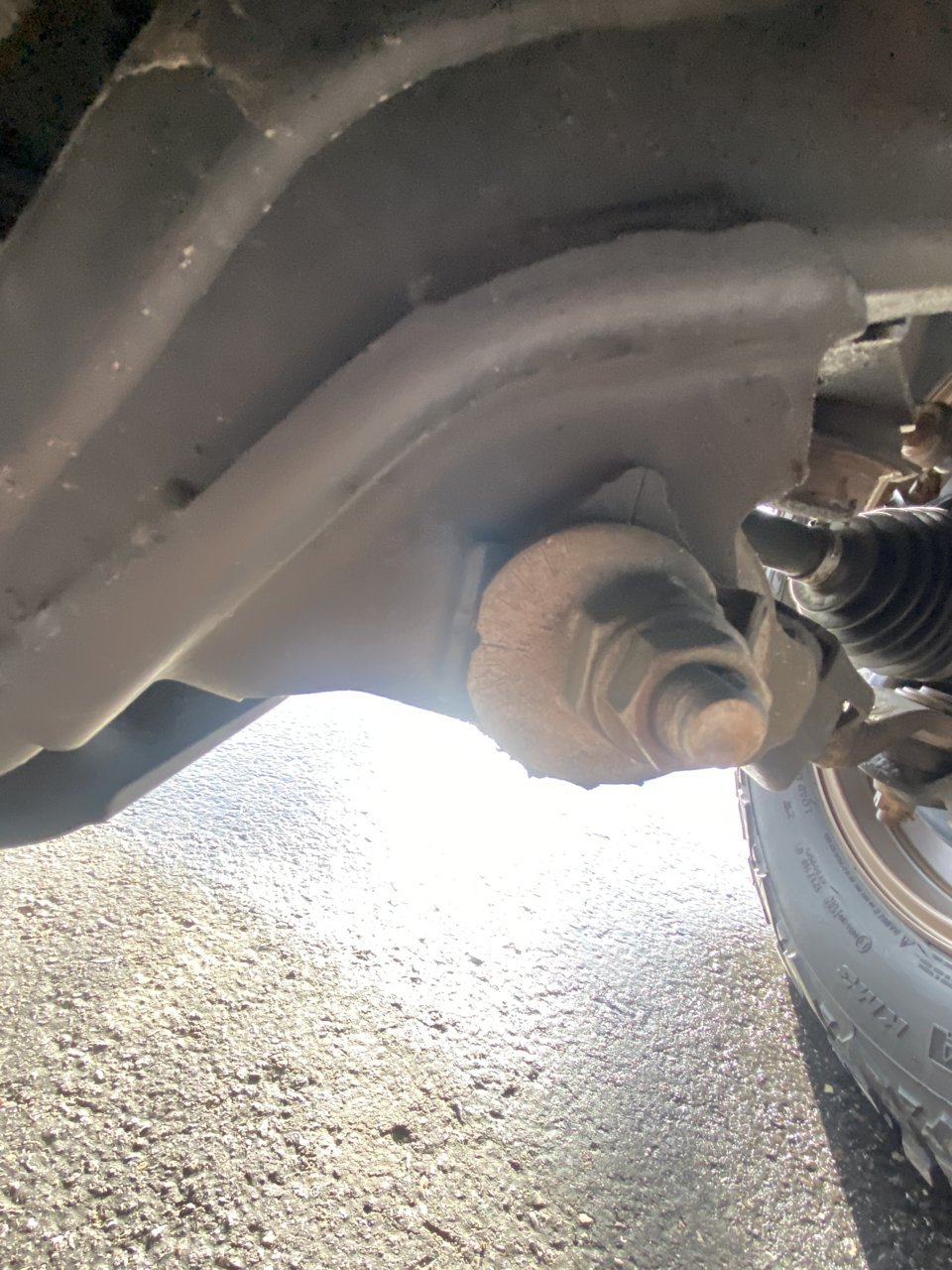

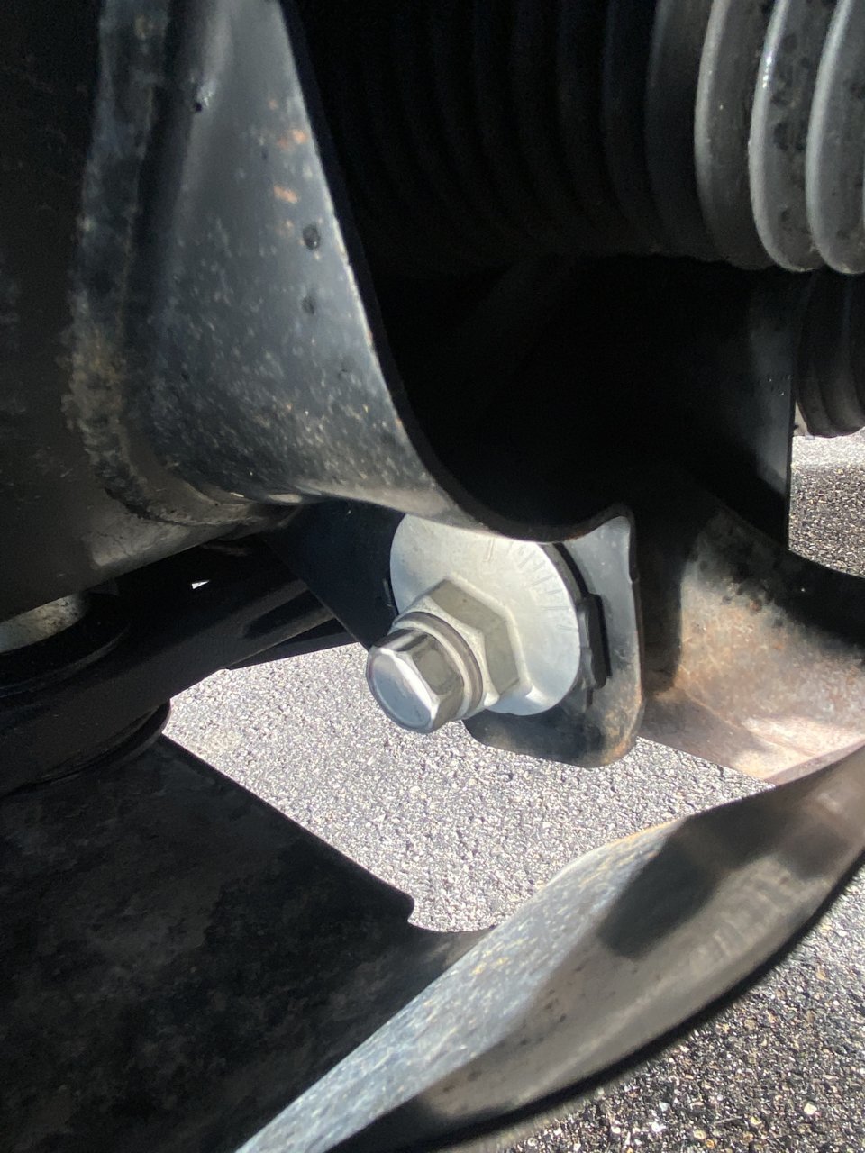

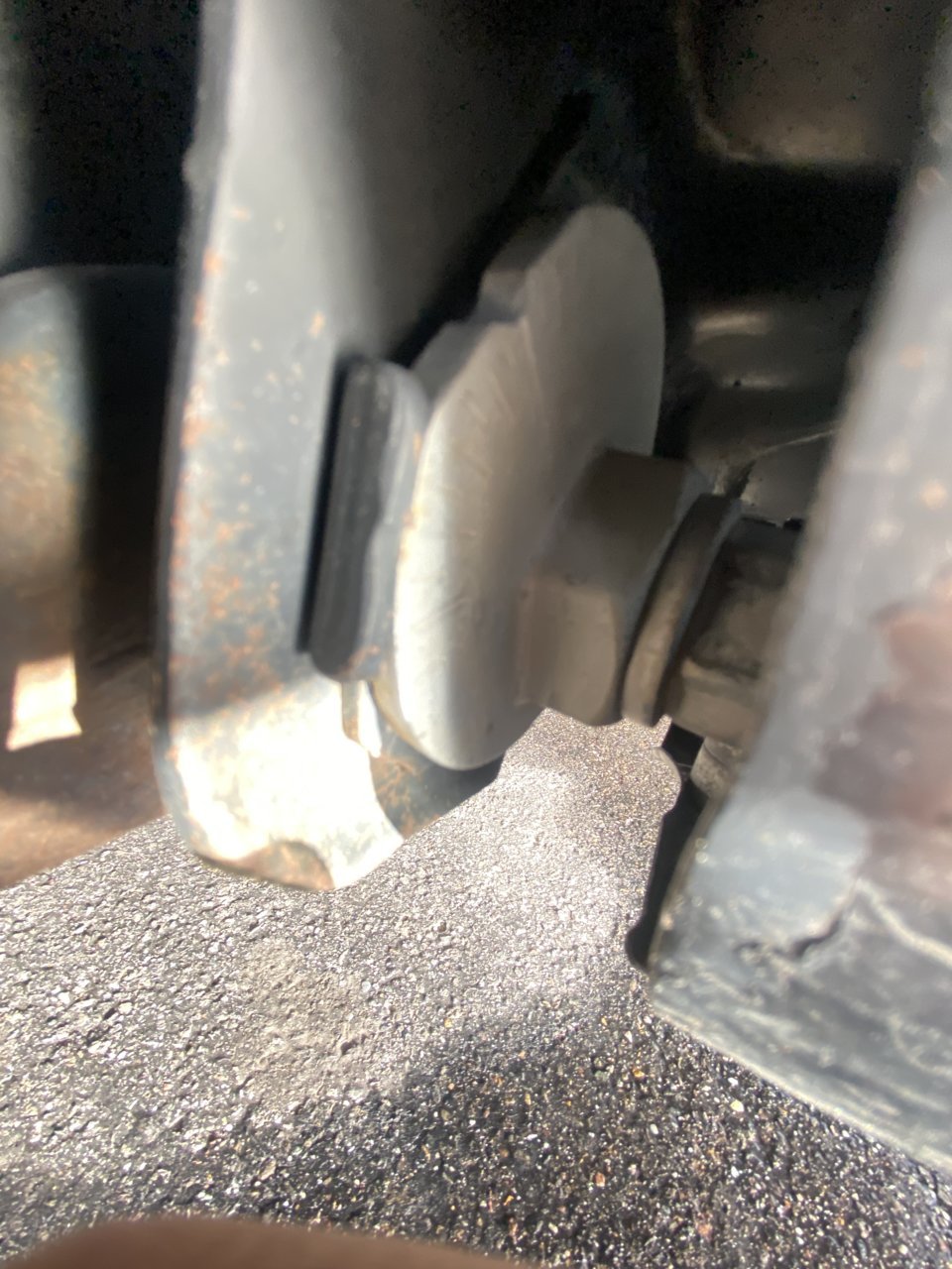

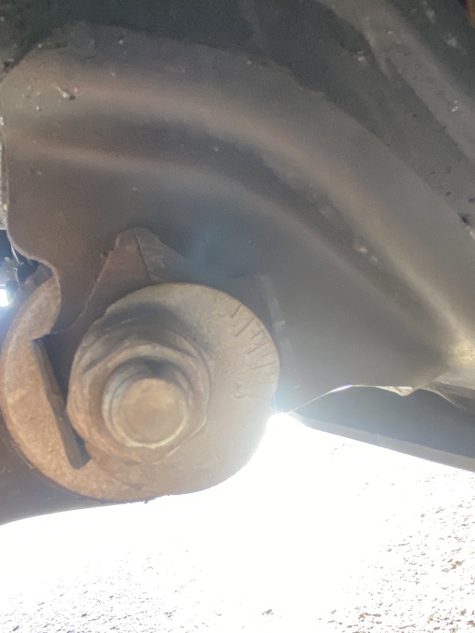

    Sorry, kinda washed out from the sunrise but no rotated cams and no bent tabs.

    Just posted some more pics of the cams.

    Kinda hard to tell from those pictures but they appear to be okay and in an orientation one could expect to see them in depending on alignment specs but I'm no alignment guru. If its not the cam bolts then a good chance you bent your spindles, it may be worthwhile getting a second opinion from another shop.

    I rest my case. Those cams look within ranges. Seems like you’re spindles are done.

    spindles look bent

    By the geometry, it appears to be an issue in the lower rear of the adjustments. By that I mean something in the bottom (Like an LCA) rear is likely bent. You're going to have to get it put up on a frame jig but if you wanted to gamble, I'd start with LCA's and new cam bolts, Left side would be my first stop. If it comes in more than ~35% towards the toe and camber range before adjustments, you've found the problem. I don't agree with a bent spindle as it's 4x4 and the amount of force required would have damaged more than just that.

    Speaking from first hand experience, this isn’t accurate. Three separate trucks I’ve wheeled with on separate occasions have bent their spindles, and only their spindles. They’re a fuse of sorts, they’re not particularly hard to bend on a good hit.
