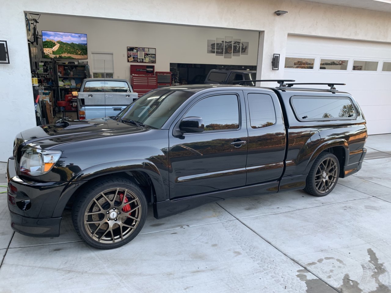

    Happy shitbox:

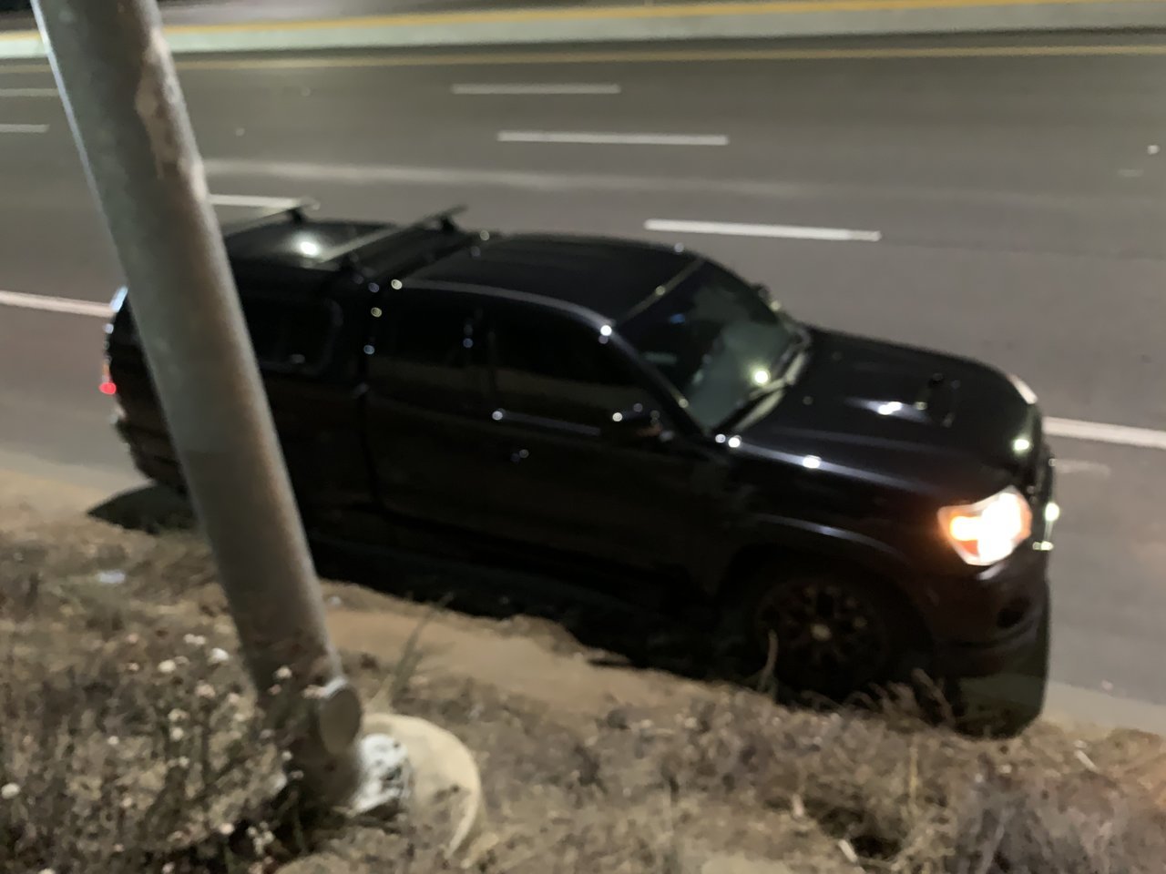

    Sad Broken Shitbox:
