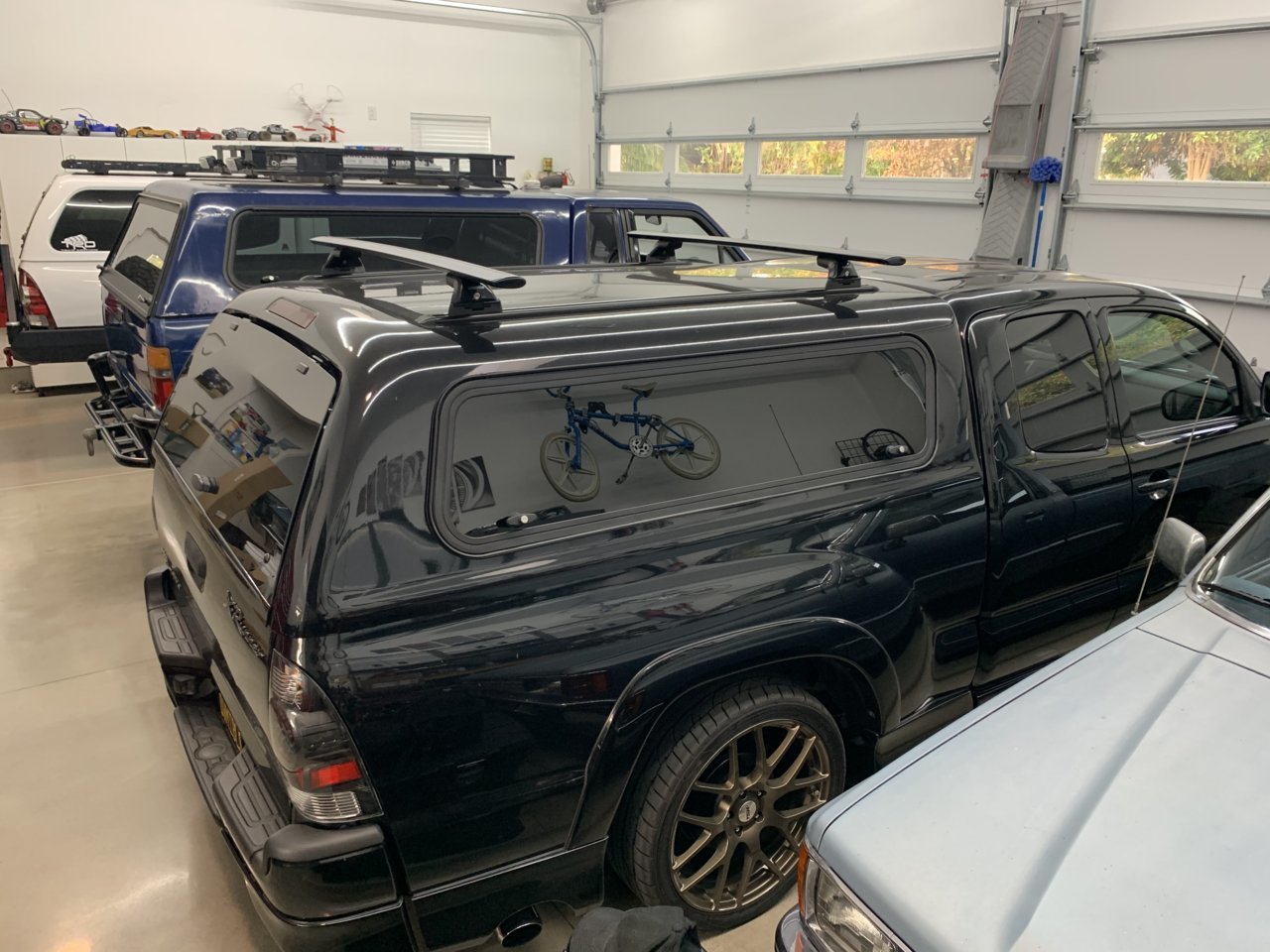

    Nice, happy and fast solution.
    Is that your bike in the reflection of the cap window? SIIIICK

    It is.
    87 GT Pro Freestyle Tour. Have had it since new (minus the 20 years it was up in the rafters in my parent's garage).
