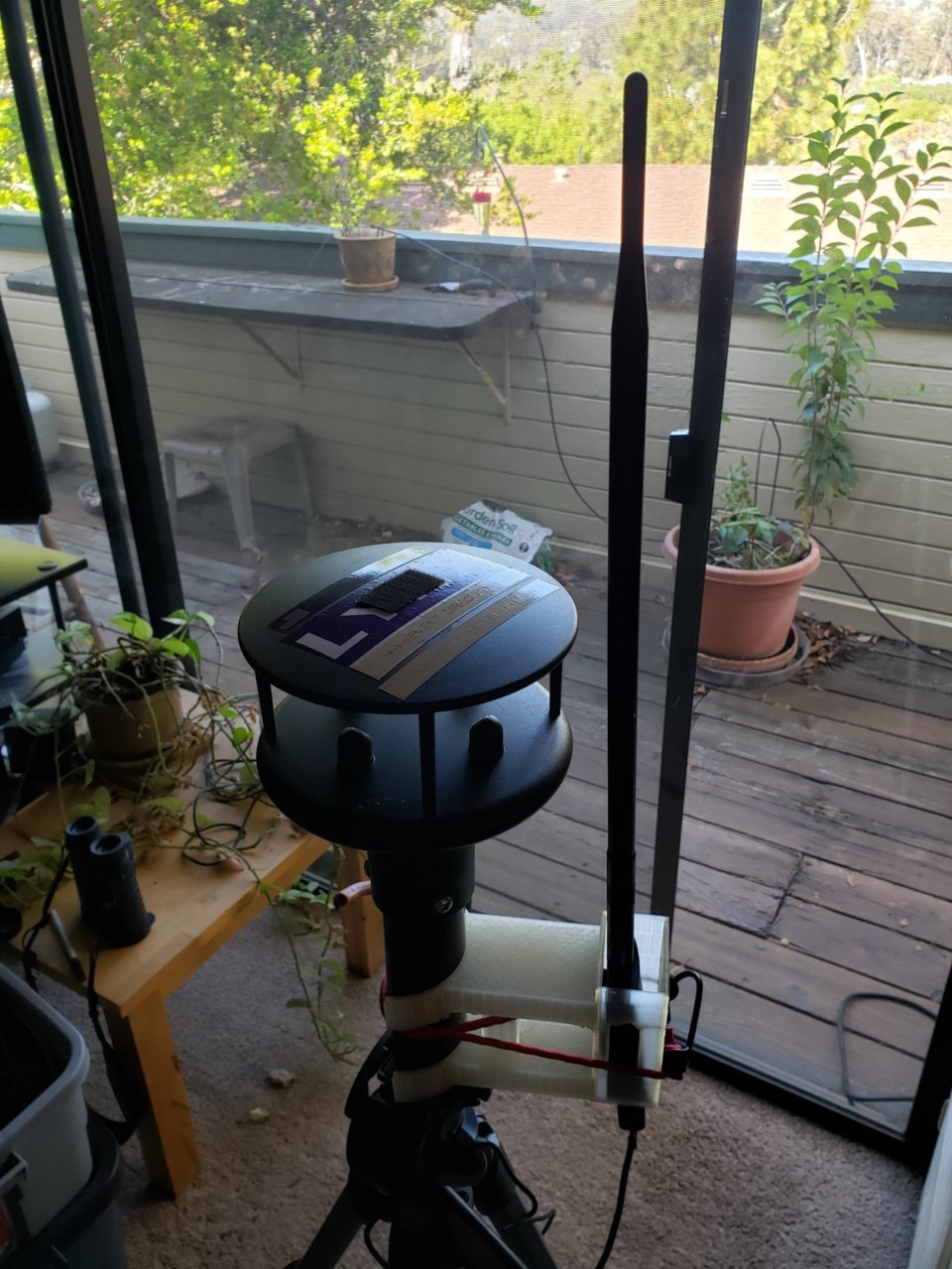

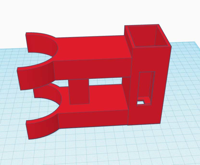

    I time sporting events and have a wind gauge. Attempted to make it wireless but serial over wifi is spotty. Found a nice little adapter but needed a mount for it.

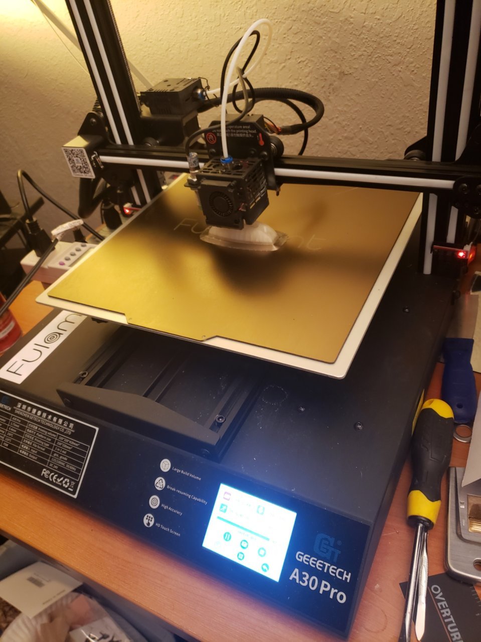

    I just printed an extruder killing blob of death. :mad:

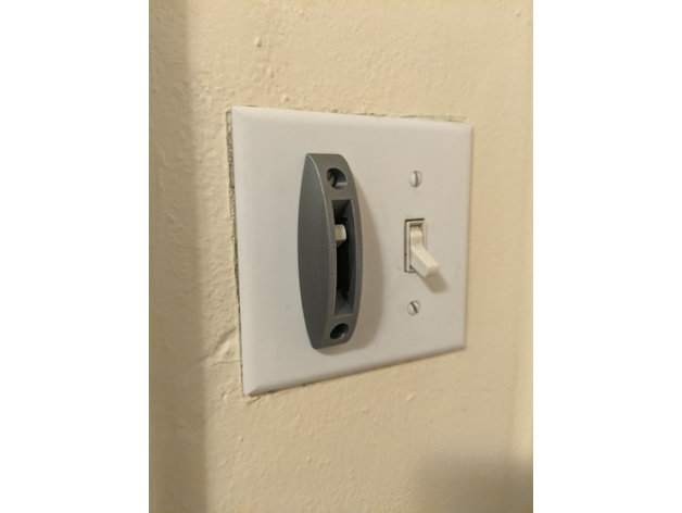

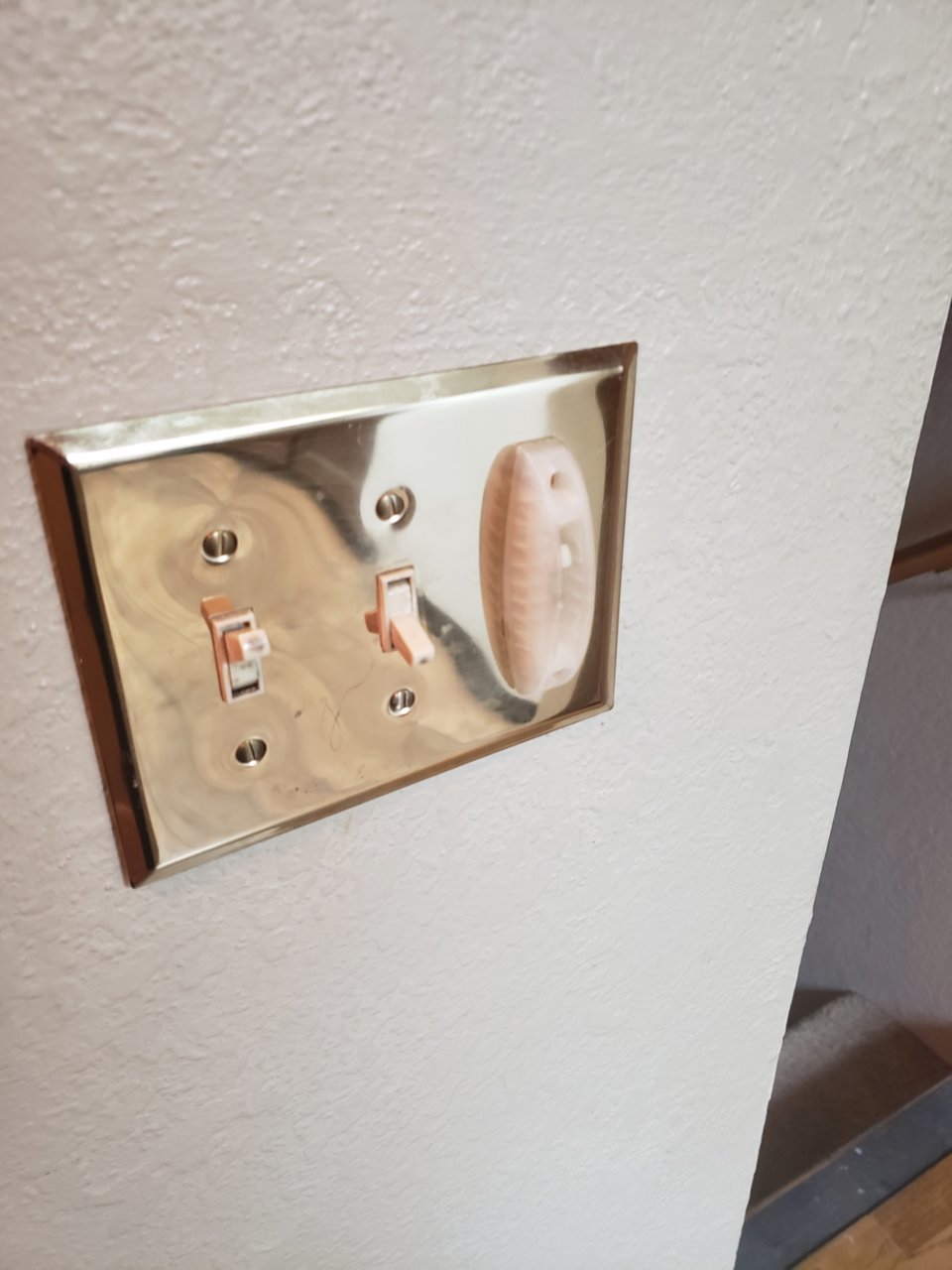

    just started this, no more turning off my motion sensor porch light by accident..

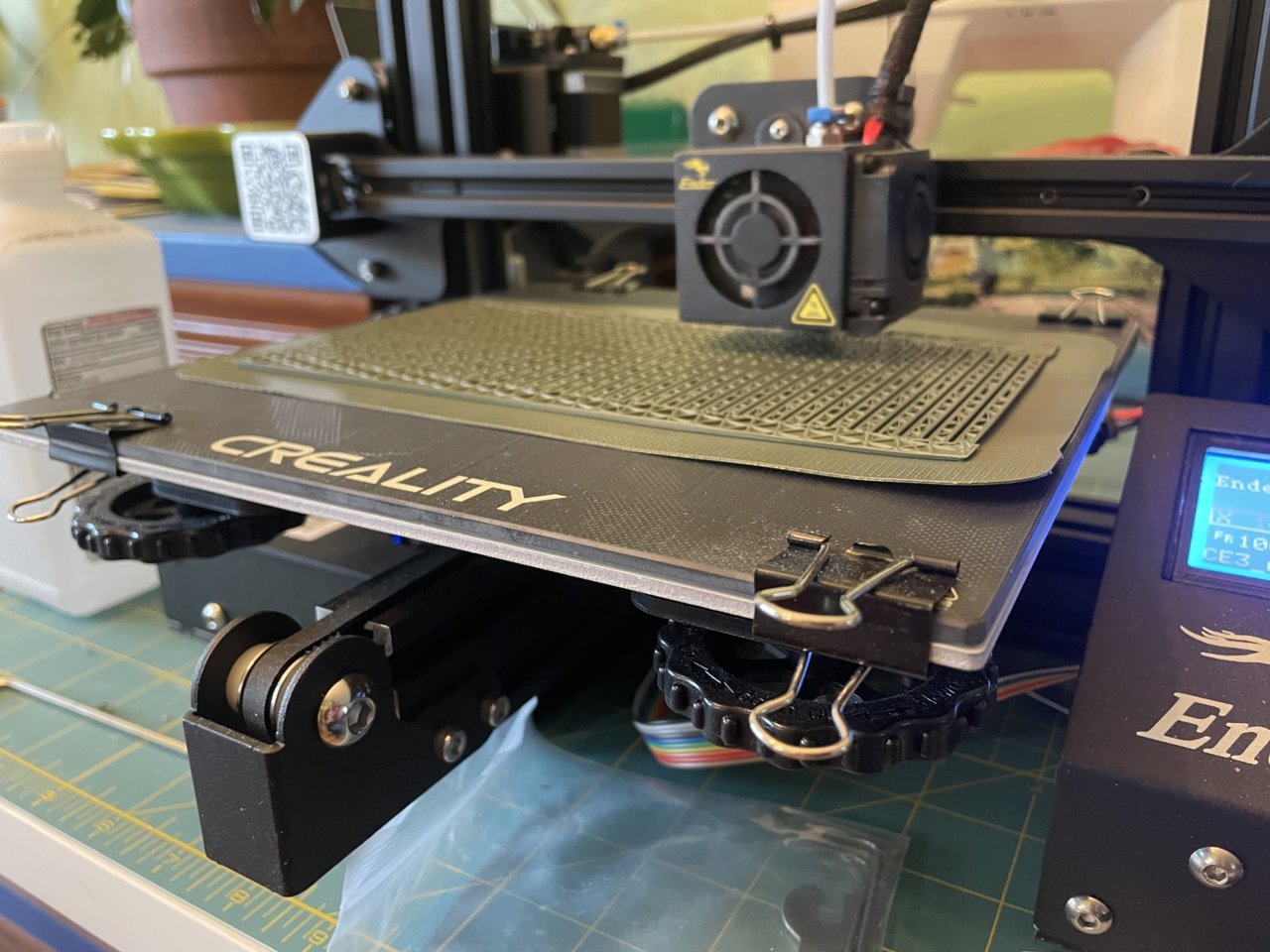

    Was trying to print one of these:
    https://www.thingiverse.com/thing:1065906
    (large flat parts for my wife’s loom)
    But ended up stopping the print after the raft peeled up:
    Going to try again tomorrow, and I’m going to clamp the raft down this time.

    whats the bed temp and filament type?

    works great!

    Pre heat the bed and just before you print spray the whole bed with hair spray. I'm not kidding, it really helps it to stick to the glass bed.

    Just realized I never replied (the card reader that came with my Ender 3 died, and I suddenly had no way to get files to the printer >_< ). esun pla+, 210 deg C on the extruder, 60 on the bed. Tried 65 on the bed but it didn't help.
