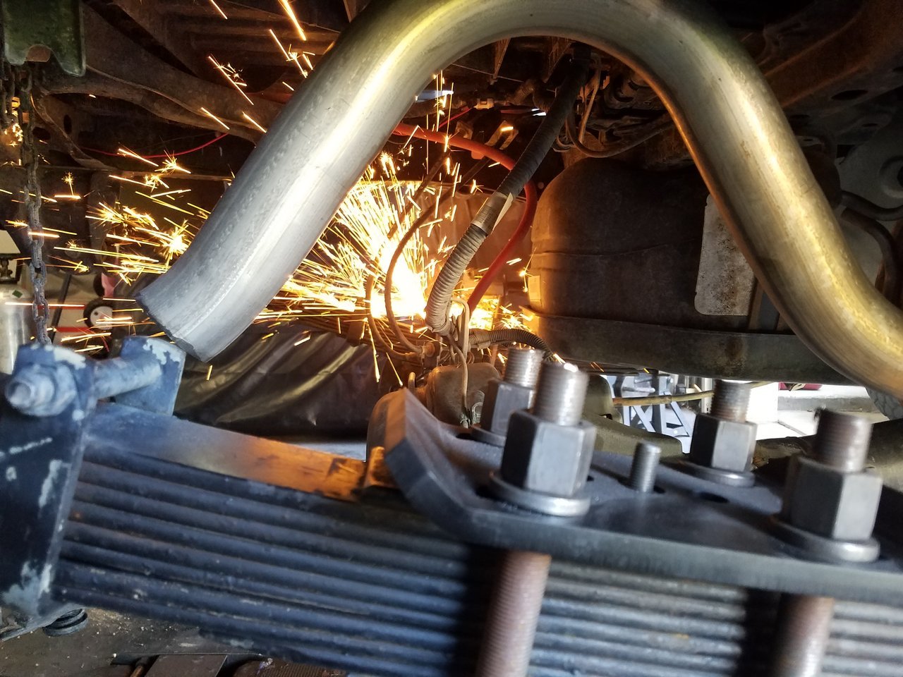

    Chopped it right after the axle. No sound difference, won't mess with any emissions. Hit it with some high temp black spray paint.

    Yup, just dump it behind the axle like that ^^^

    I did same as above.

    Well it looks like the thing to do is just cut it and forget it. Thanks guys,

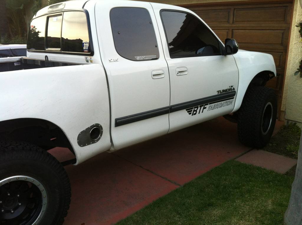

    Gathering parts to make my own cat-back. Ill take it from the y-pipe, to small muffler, over frame rail and out the fender, in front of the rear tire. Look doable.

    Plus how cool would it be to have a bedside exit exhaust?!

    Bedside exhaust doesn't work in the off-road world. One look at all the scrapes on my sliders will tell you that.
    And I've touched up paint under my bumper enough times that I know my exhaust pipe would be GONE if I hadn't chopped it.

    The tailpipe would be protected in the position I am thinking of. My sliders would protect the exit.

    Something like this. Found a second gen with similar the other day, but its is MIA right now...
