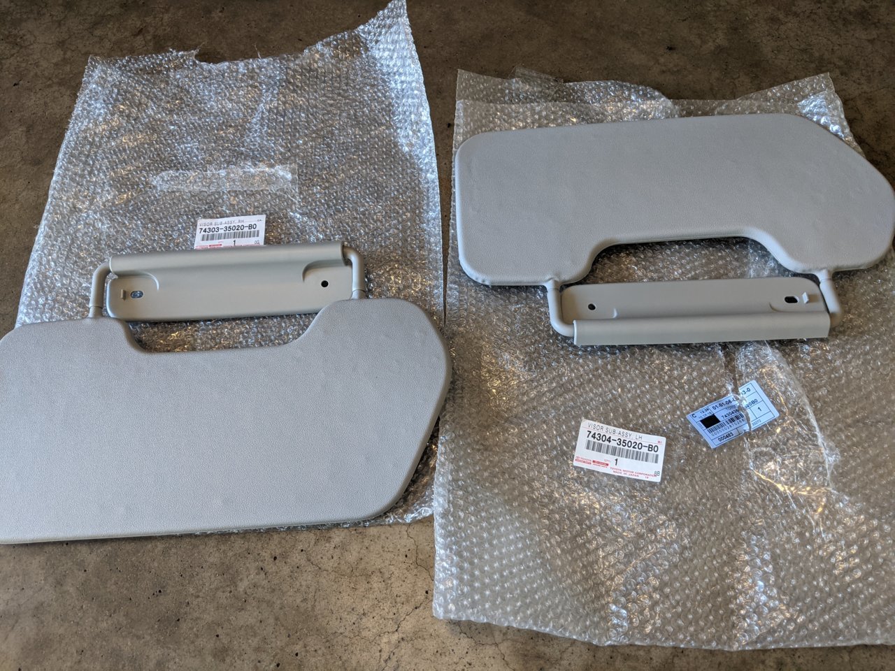

    Installed the side visors

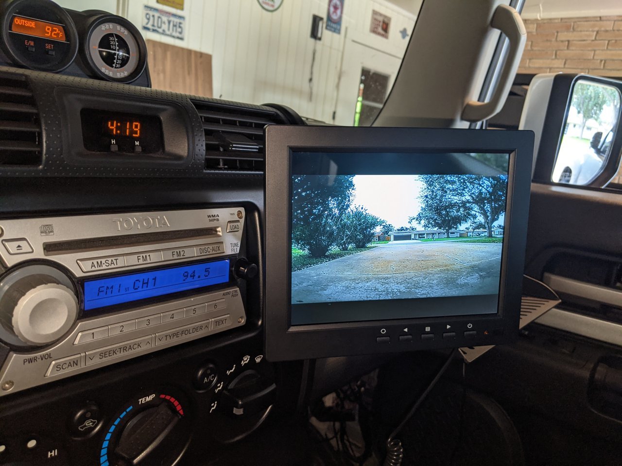

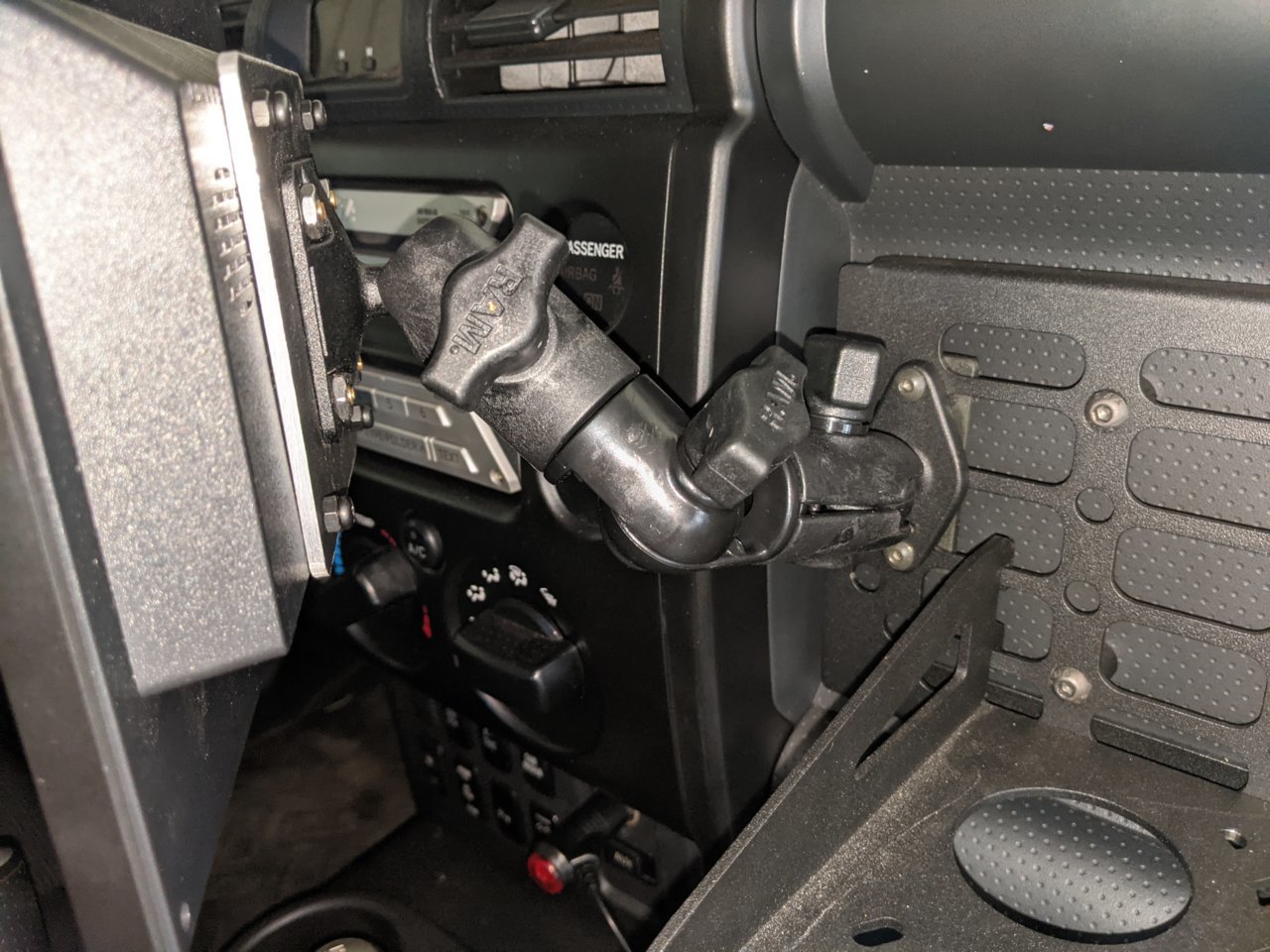

    Installed a Ram mount and an 8" monitor for the backup camera.

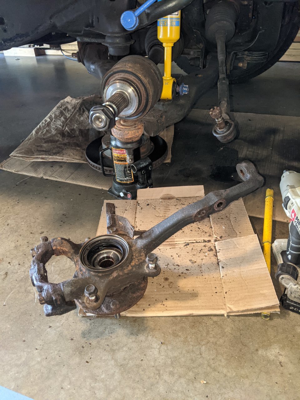

  8. Sep 20, 2021 at 5:01 PM
    #48
    Daves300
    Daves300 TTC#0333
    Mar 20, 2020
    #322554
    301
    Texas
    2007 FJ

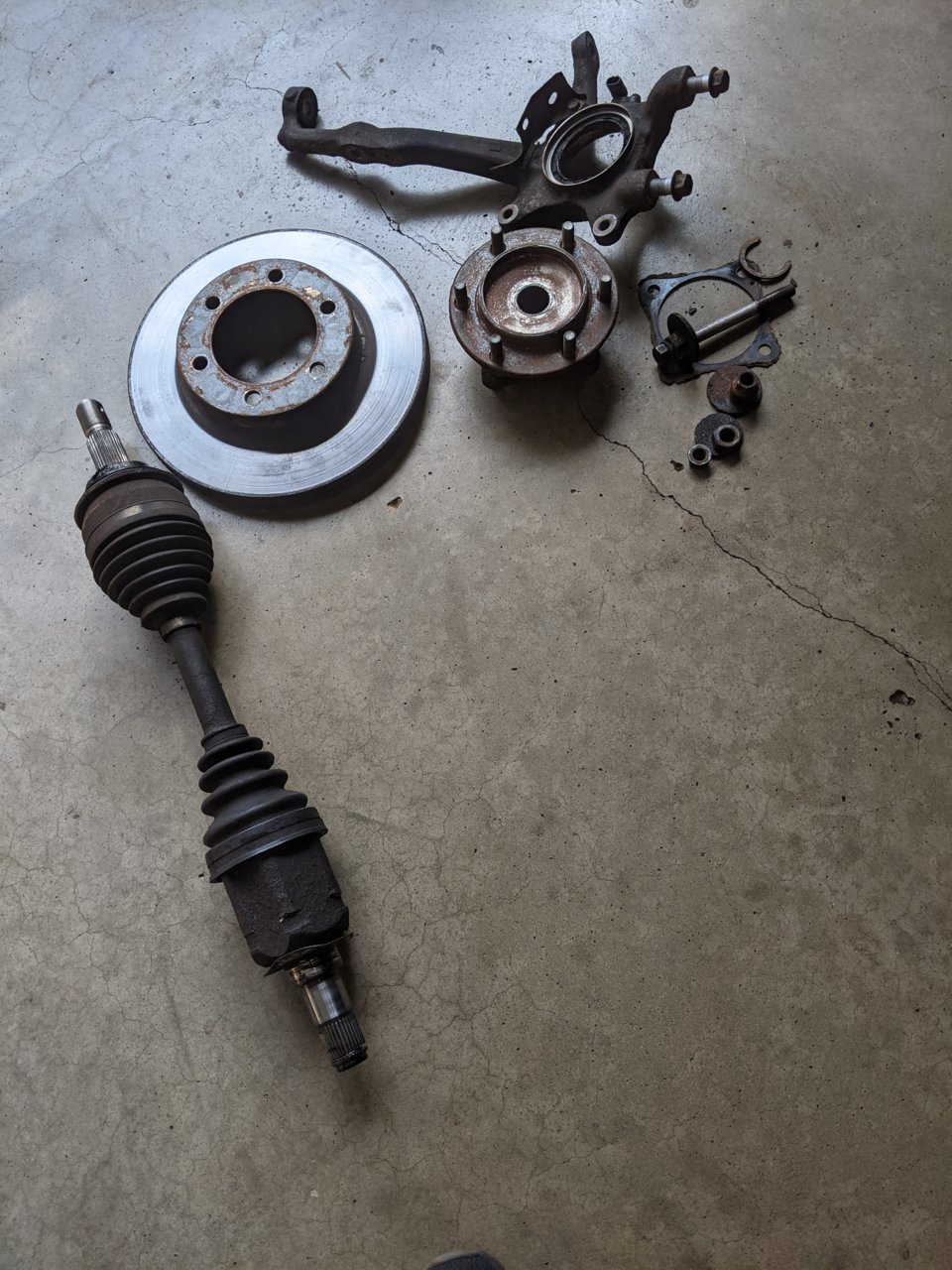

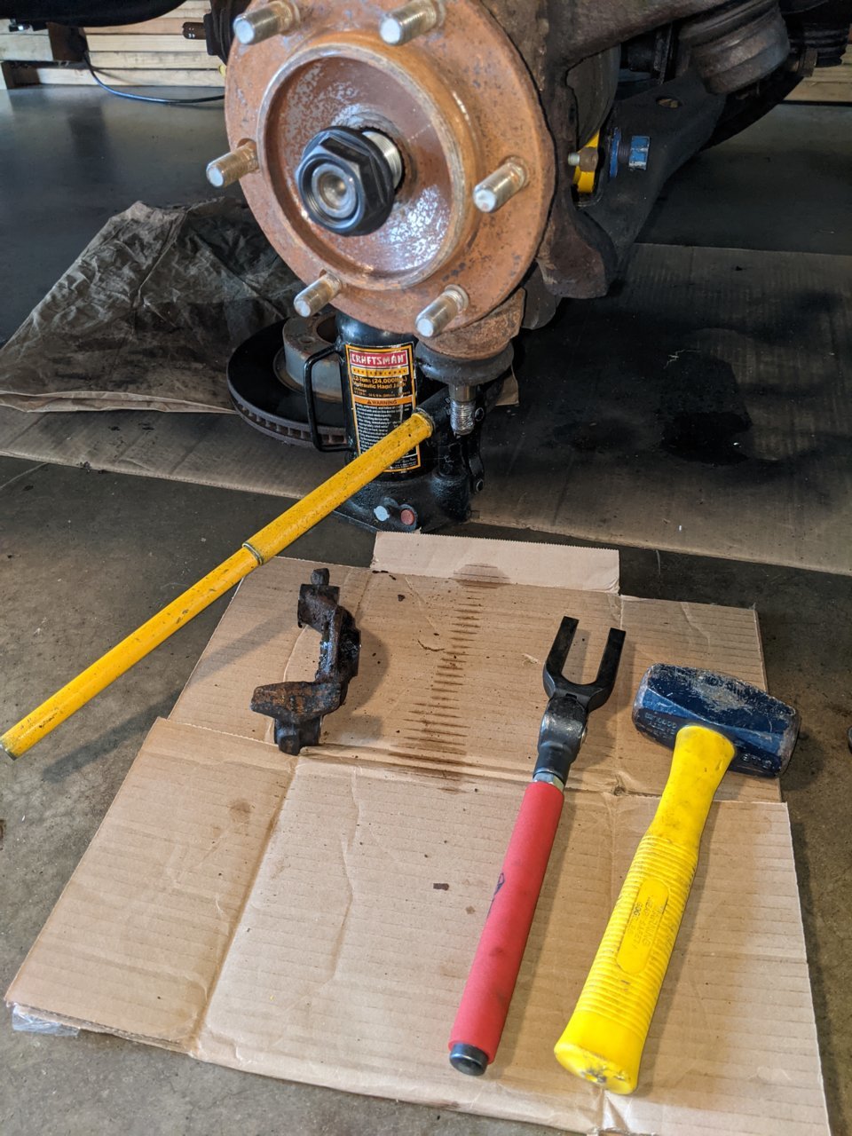

    Got that lower ball joint to separate
    Removed the spindle
    AzogSS likes this.
  9. Sep 21, 2021 at 2:48 PM
    #49
    Daves300
    Daves300 TTC#0333
    Mar 20, 2020
    #322554
    301
    Texas
    2007 FJ

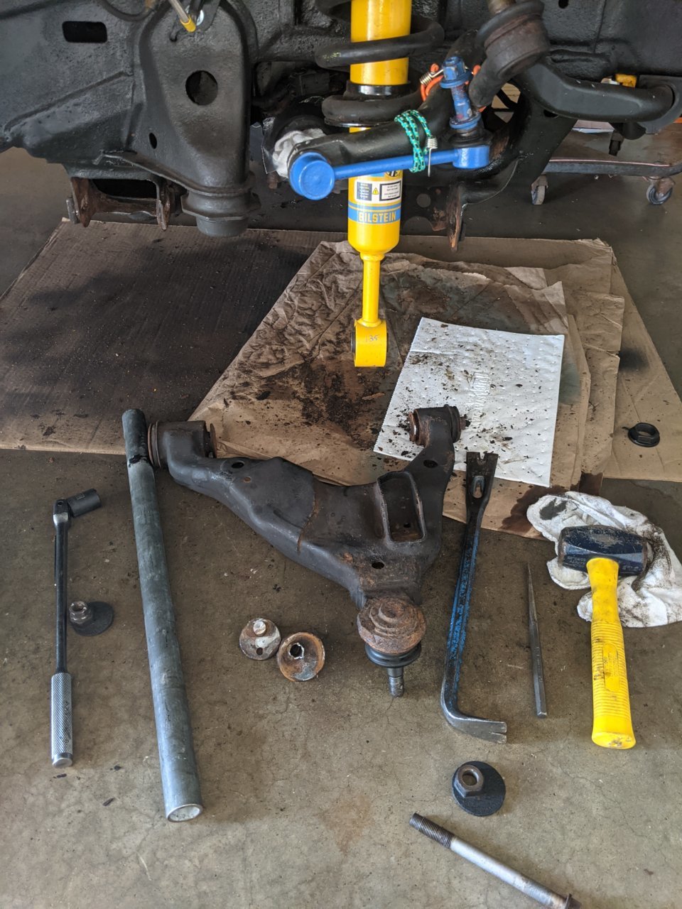

    Got the axle and lower control arm off.
    Some shearing action here
    It just didn't want to let go

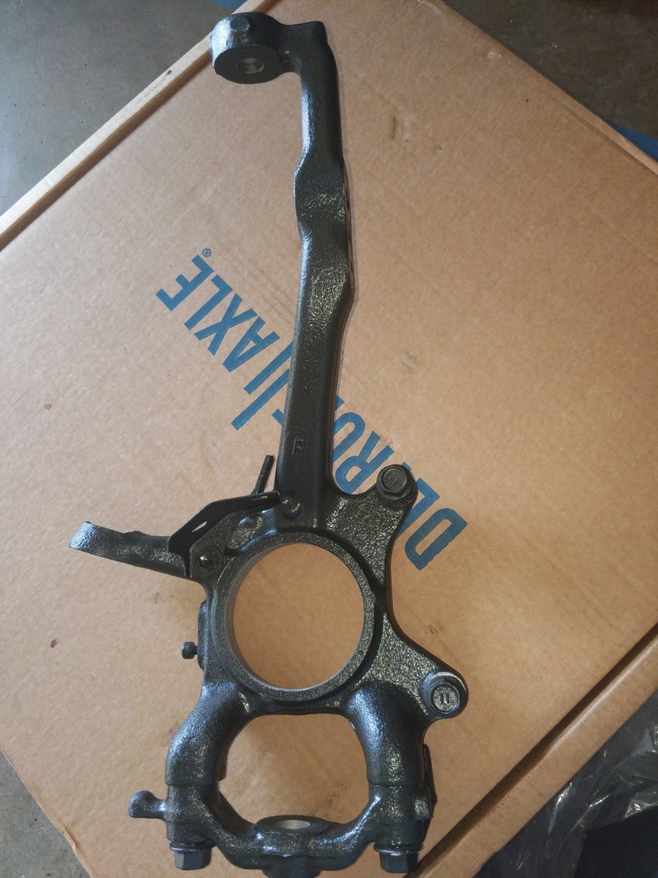

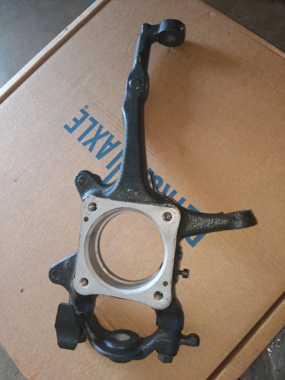

    Here's the spindle, sand blasted and repainted

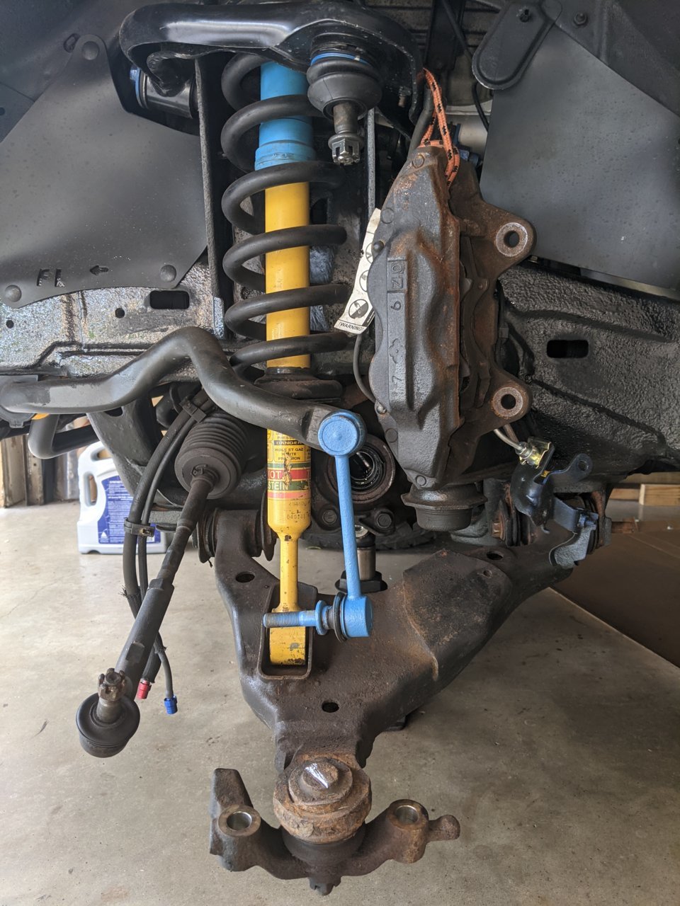

  11. Sep 21, 2021 at 6:41 PM
    #51
    Daves300
    Daves300 TTC#0333
    Mar 20, 2020
    #322554
    301
    Texas
    2007 FJ
    It's going that way.

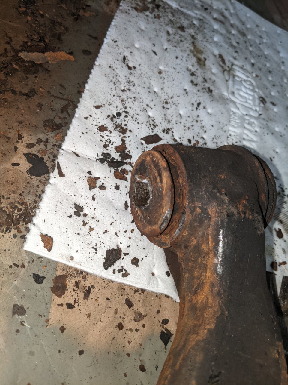

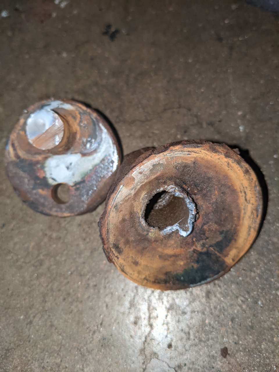

    This side had a torn boot, then I found the cv joint was worn out. :facepalm:
    Then, when I turned the hub by hand I could feel grit in the bearing. :frusty:
    And, when I tried to move the lca out of the way I found the bushings were seized.:sawzall:
    The other side has a leaking hub seal, I'm expecting to find the same problems there.
    ValK83 and AzogSS[QUOTED] like this.
  12. Oct 11, 2021 at 2:45 PM
    #52
    Daves300
    Daves300 TTC#0333
    Mar 20, 2020
    #322554
    301
    Texas
    2007 FJ
    The left side is coming apart the same as the right did.
    Will have to sawzall the LCA out.
    And cut the nut off the ball joint.

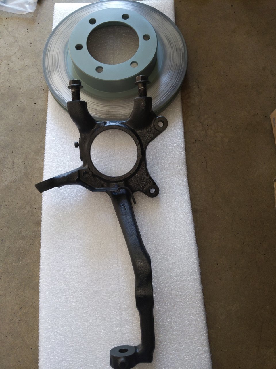

  14. Oct 12, 2021 at 1:30 PM
    #54
    Daves300
    Daves300 TTC#0333
    Mar 20, 2020
    #322554
    301
    Texas
    2007 FJ
    I don't think you will, so long as the previous owner didn't park the truck in the ocean.

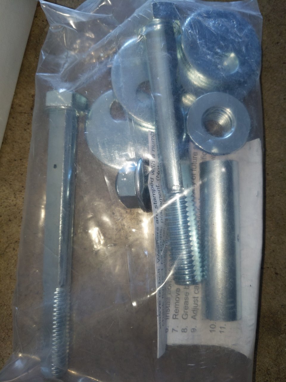

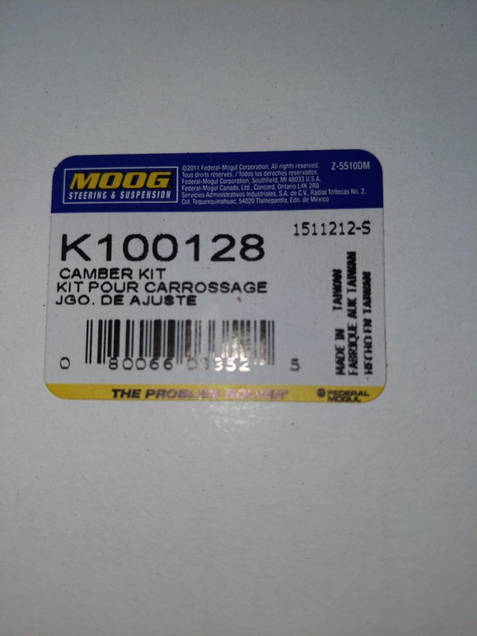

    I'm using a Moog camber kit on the reinstall because they have grease fittings, hopefully some lube will prevent this from happening again.
    Spindle cleaned up real nice.

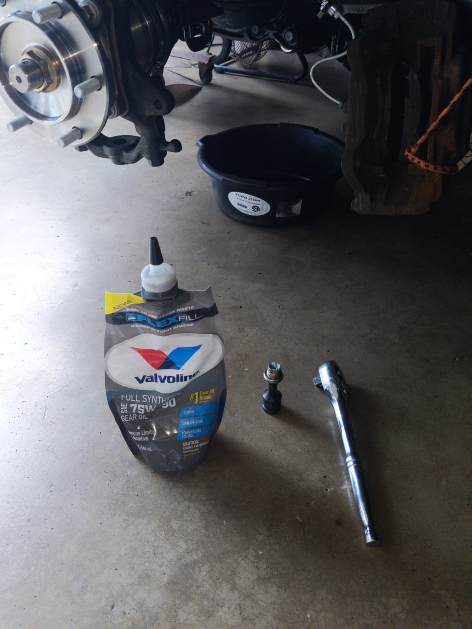

  15. Oct 17, 2021 at 1:12 PM
    #55
    Daves300
    Daves300 TTC#0333
    Mar 20, 2020
    #322554
    301
    Texas
    2007 FJ
    Refilled the front diff.
    From the perspective of refilling, I highly recommend these bags. They are the quickest and cleanest ever.
    AzogSS likes this.

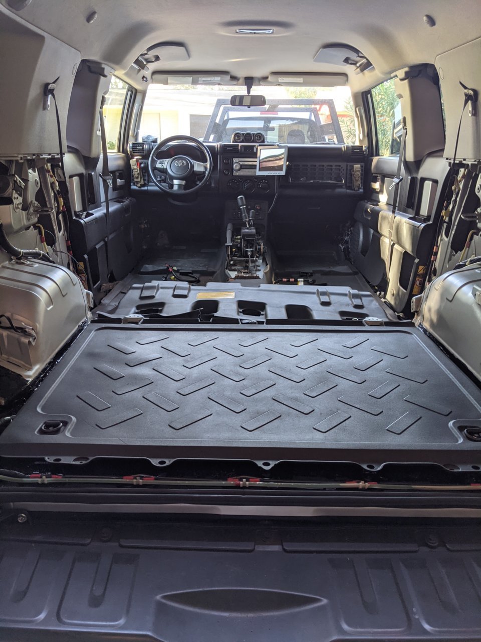

    After painting the frame and underbody, I still have about 1/3 gl of POR 15 left. So, I decided to remove the interior and paint the floor.

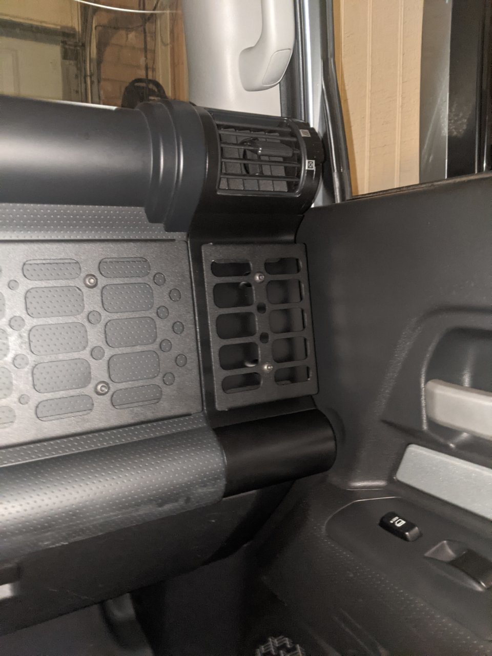

    Andy
    Soda City, SC
    2008 Tacoma / 2011 FJC

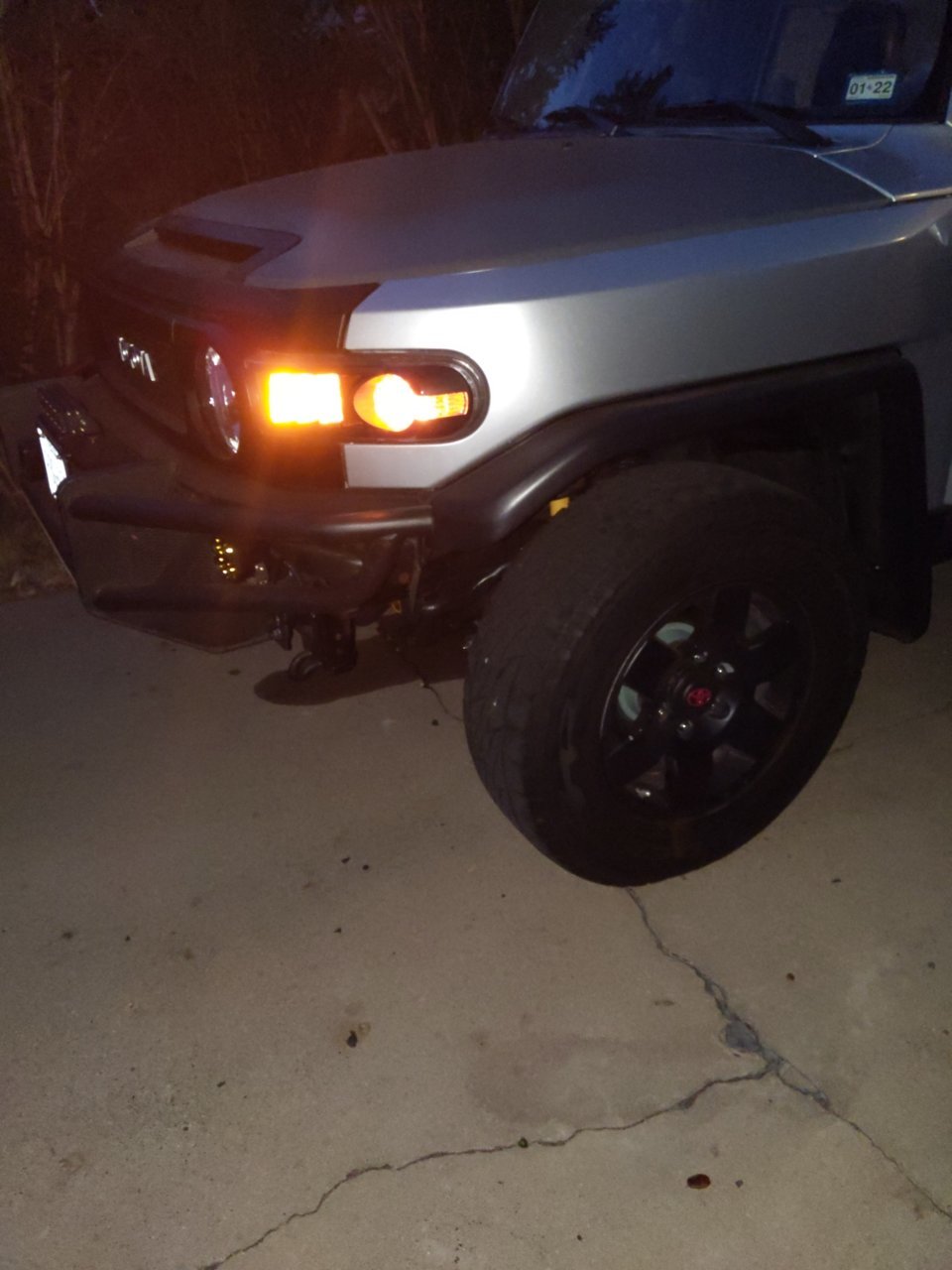

    Winch control mount in, horn relocated (not pictured), and TTUE white OEM grille put in. E33444E5-7356-4C7D-BB2A-4589968FE202.jpg796758C9-B233-4761-BFC6-454EC400CE47.jpg
