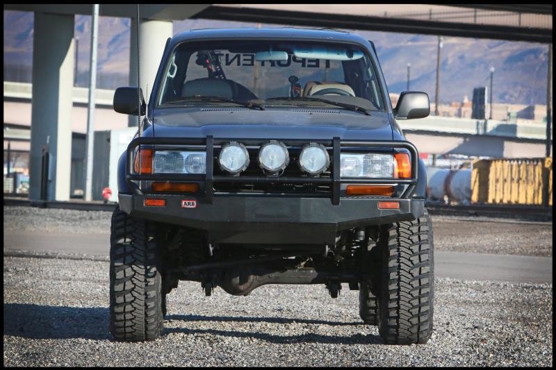

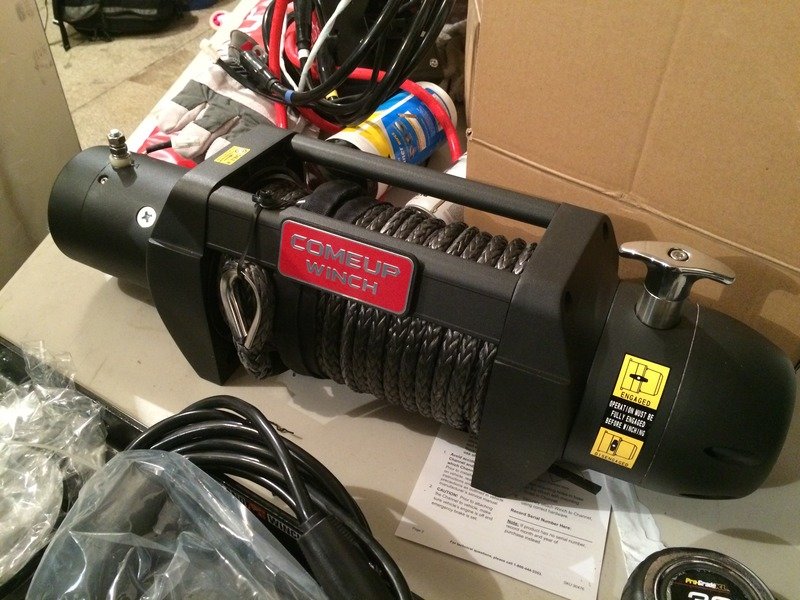

    I suppose I should add something that I've been working on recently. I'm working crazy hours at work right now and I'm lucky to be home before midnight so its been hard to find time to get anything done. However I'm in the process of getting my new winch set up. I've got a COMEUP Gen2 SEAL 9.5s
    The ARB bumper on my cruiser has been modified. It was all done by the previous owner who cut off all the winch mounting brackets and lower skirt. He never planned to run a winch and wanted a cleaner look. I actually like how he did it.
    Normally on an ARB bumper you have to mount the winch with the feet forward. But since all that stuff was cut off, it allowed me to mount it however I wanted. There's loads of space behind the bumper and between the frame rails. So I picked up a Badlands winch cradle that I can weld to the bumper between the frame rails.

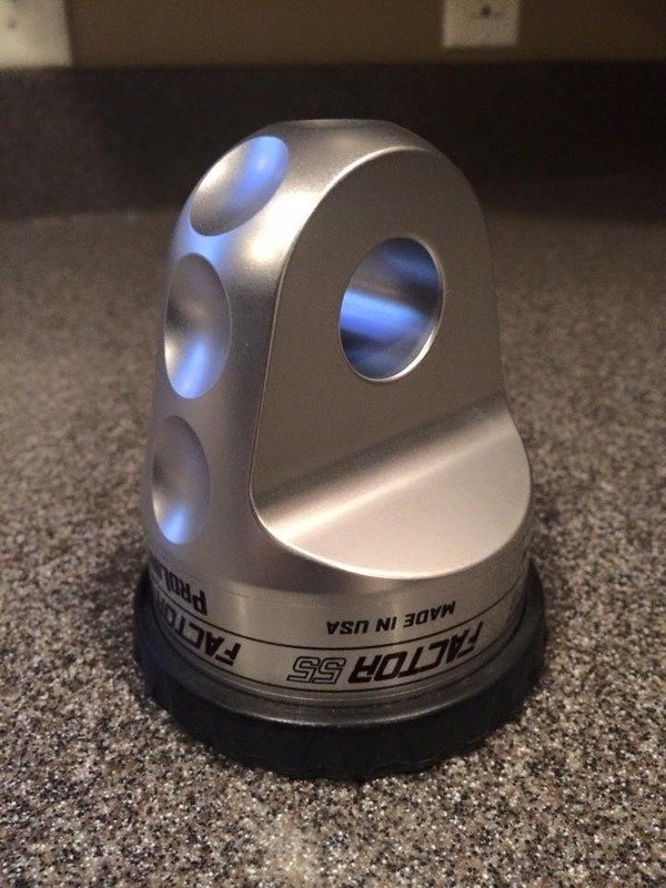

    This allows me to mount the winch with the feet down (which is preferred) so I don't have to clock the winch motor. The COMEUP comes with a massive hook for the winch rope, but I won't be using it since I picked up a Factor 55 ProLink.
    I'm hoping to have this all finished up this week as I try to get ready for Cruise Moab at the end of the month. Once the winch is done, I will be tearing the front axle apart to replace bearings and seals. Gotta figure out how to make time for that too before the trip.

    I have no doubt the winch is going to hold up great. I think Warn is the only brand that compares to the COMEUP. They're a pretty new company so not a lot of people know about them yet but they are pretty impressive. I talked to the President/CEO from COMEUP in Moab last week. The guy is doing it right. There's no cutting corners and he's committed to making the best winch on the market.
