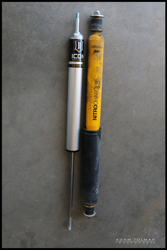

    I did. Overall all length is not too different, but the stroke is better with the ICONs. It's hard to tell with the sleeve that covers the shaft on the OME shock. The shocks control the bodyroll quite a bit better so it's also possible to not run a swaybar in the front which helps flex too.

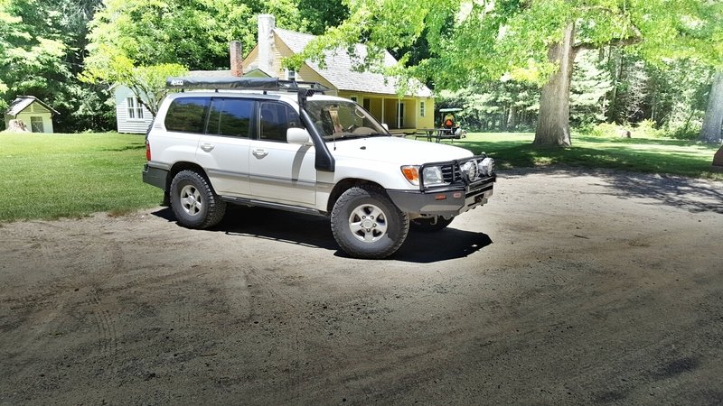

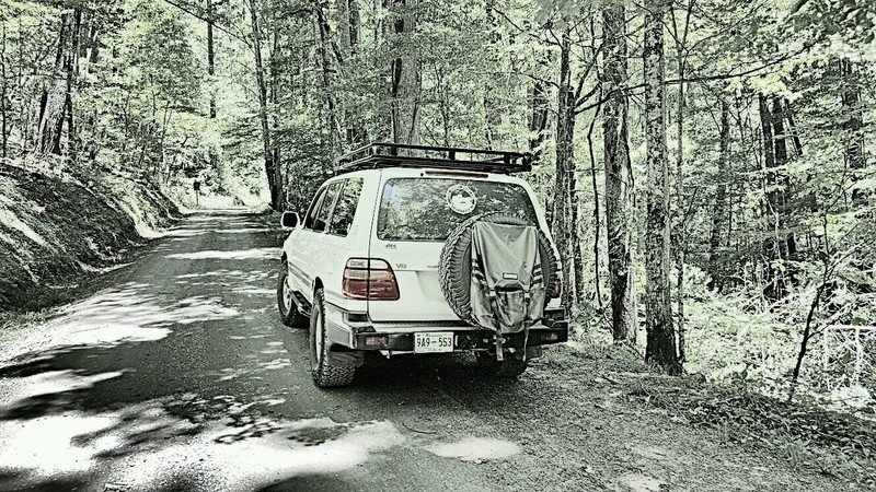

    If you're on MUD, you may have already seen my new 100 series but thought I would post it here. I sold my 80 series that I spent most of last year building, mostly because I wanted back in a 100. A fellow MUD member sent me a message about this one and it actually worked out. The original owner was a Expedition Portal member, Doron Strausman. He bought this one new and did 95% of the build. He sold it to a good friend that didn't drive it much. It's a 1999 model and when I bought it in May, it had 98,000 miles, it was used as a expedition rig so only averaged 4500 miles a year.
    Here's the specs
    1999 100 Series, 98,000 miles when I bought it, came from Arizona so no rust, 2" OME suspension with Slee torsion bars, 4.88 gears ( amazing how much better the gas mileage is with the lower gear set ), rear e-locker, front ARB locker, ARB compressor, ARB front bull bar, White Knuckle Sliders, Warn HS 9.5 winch, Warn driving lights, Safari snorkel, TJM rear bumper with spare swing out, 43 gallon sub-tank, new 315/75R16 BFG KO2 tires, ARB frig, custom rear storage system, 15 gallon fresh water storage with pump and spigot, full roof rack, HEO awning, CB and Ham radio.
    Here's a few pics from a recent trip to the mountains of western North Carolina and east Tennessee.

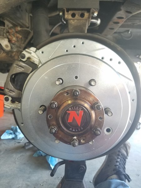

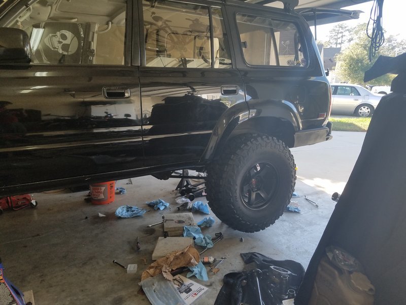

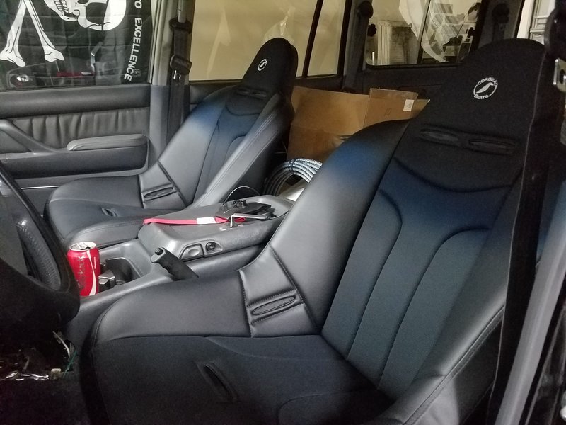

    Ummmmmm parts finally starting to make their way onto the Burrito
    tmp_29086-20161024_134835862241347.jpg tmp_29086-20161024_143008-612717485.jpg
