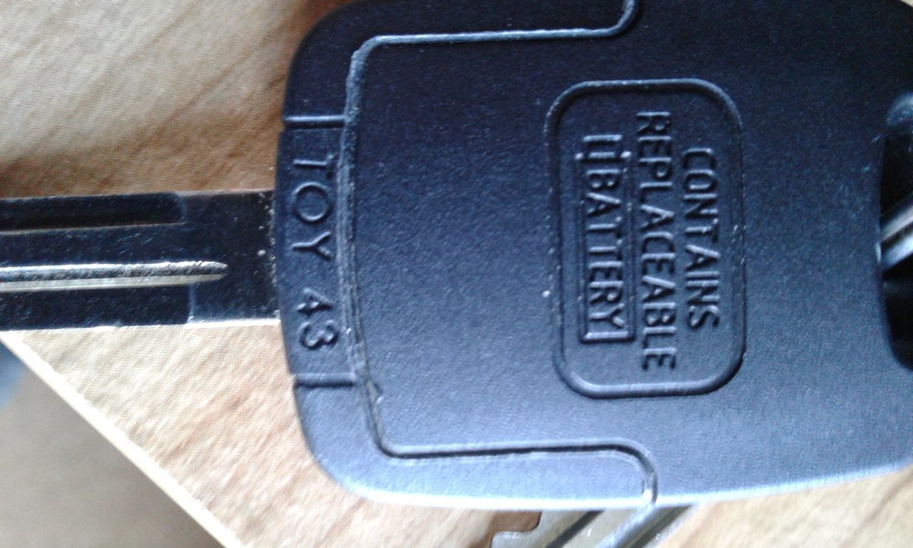

    I paid $80 at the local ace hardware store.
    What pisses me off is that the damn thing has a battery in it. I did not notice till I got home.
    The truck will not start without this battery so obviously it's not reliable.
    I use this key as the main key so when the battery does go dead, I will know, and then I can use the original key for a backup.

    Uh, The key does not have a battery. It is a passive chip like in a credit card RFID.

    Uh, I seen it. It is a real battery. CR 3223 With a + on one side and a - on the other.

    That is not the key battery. That is the automatic door lock FOB.
    The key has no power source. It is a passive ID Chip.
    Are you trolling me or do you just have no knowledge about this subject?

    Ok little jimmy, I will dumb it down for you....
    This is a key....
    Inside this key is a battery, without this battery the truck will not start.
    Read this post as slowly as you need to so that you can understand.

    OK, I didn't realize that you bought a cheap aftermarket knockoff.
    The OEM Transponder System does not use or need any batteries. It uses a passive RFID chip in the key that gets power from the inductive coil in the steering column.
    Sorry you were not able to read the information about the cheap knock-off key you bought. Enjoy your batteries.
    Hillman Cd Toy43-ek2 Toy Elec Ky
    About this item
    Replace your Toyota's lost or damaged transponder key with the TOY43-EK Toyota Transponder Key. The key uses a lithium battery and is proudly made in the USA. Hillman Cd Toy43-ek2 Toy Elec Ky.

    As I'm understanding it, both of you are right. Correct me if I'm wrong, but non-Toyota keys have a battery and genuine Toyota keys don't. Do I have this right?
