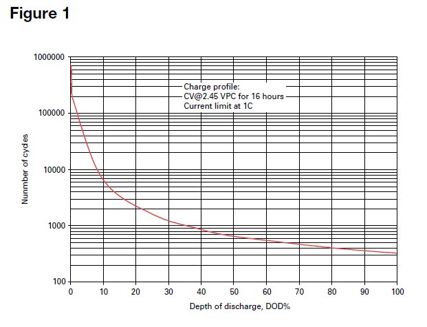

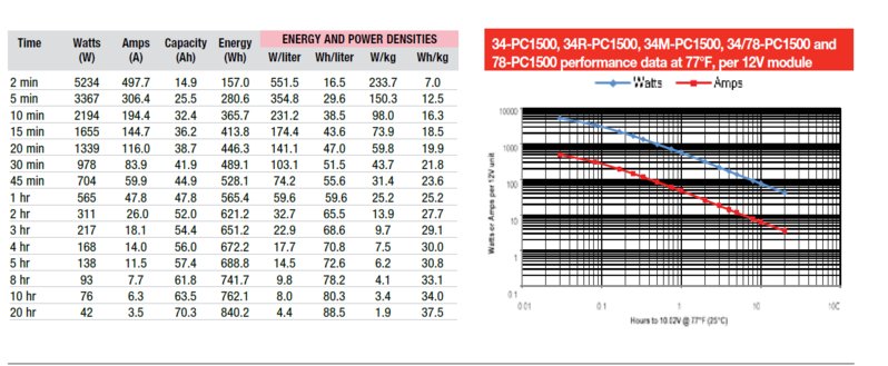

    It's really not a wise idea to draw 400W from the inverter with the engine off as some seem to desire. A battery is energy storage rather than an energy source. A typical automotive battery only has 50-60Ah of capacity and voltage will drop before you actually use that much. At 400W you are using about 33A of power and anyone who wants to install a really big inverter (1-2kW) would need an upgraded alternator to support it. Unless your using a small load it's better to consider your engine a generator and should leave the truck on.

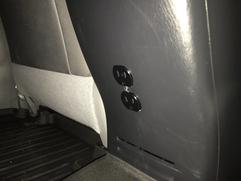

    I did the 400 watt anytime mod and wired in a outlet in the back of the center console. I have used the bed outlet to run a LED work light a couple times. Inside the cab its used all the time to charge the kids iPads or charge a laptop. I even run a heating pad off it once.

    I added a 1200W inverter under the driver's seat and installed outlets into the back of the center console. This is perfect for the wife's laptop and the kids tablets. Phones charge way quicker than using the 12V lighter socket.

    There is also the fact that the starting system battery is a (surprise) starting duty, not deep cycle, battery. Typically they use 3 to 5% of their capacity when starting the engine, which is rapidly replenished by the charging system once the engine starts.
    However starting duty batteries do not do well in deep cycle applications; i.e. being repeatedly run down (even if only to 70 to 75 % capacity) and recharged--doing this will dramatically shorten their life...
