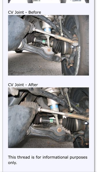

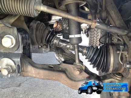

    ^You wanted a diff drop for a reason, right? For most people it's because they see the CV joints are at an angle, and the CV boot fins are touching each other, which can wear out the boot pretty quickly:
    Yes, the diff drop causes the diff mounts to protrude below the frame outline. If you hit a rock or something, the diff gets to punch a hole in the engine like mjp2 experienced...

    For the record, there has been ONE failure(~7 years ago)caused by a modified skid plate on a RACE TRUCK during a RACE where he slammed into a rock while RACING. :anonymous:
    The diff drop does in fact improve cv angles on the 2gen Tacoma.
