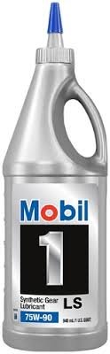

    This is what I prefer... Works for me..

    thanks guys..thats what i was thinkin id use, but should i go for synthetic? ive thought most synthetics ive seen are all LS, like the mobil 1 in this thread, and thats for limited slip right? maybe i can find a synthetic without LS somewhere

    The synthetics that say LS on them still do not likely have the limited slip friction modifiers in them, they're just safe to use with a limited slip. Regardless, even if the oil has the friction modifier for a mechanical limited slip, there is no harm in using it in your open differential. It's when you have limited slip and don't use the right stuff that you run into problems.
