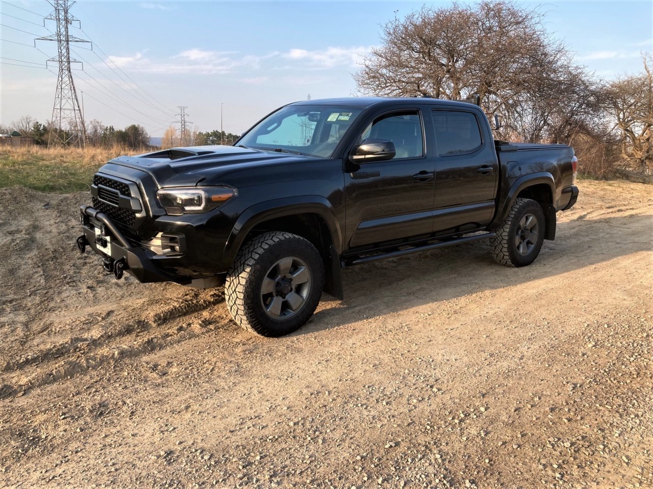

    I applied Cquartz UK 3.0 almost 3 years ago now.
    Did the full paint correction myself
    (it is real easy to do with a cheap DA random polisher, watch a few youtube videos you'll be surprised how easy it is).
    The consumer grade ceramic coatings are actually very easy to apply, don't be daunted by them.
    After a few youtube videos you'll realize that applying the coating is actually not much different than waxing your truck.
    Every 2-3 months I wipe down the truck with carpro reload when I hand dry after a spray wash.
    (which is less effort than applying a wax or sealant).
    Water still beads real good on the truck, not as good as when I first coated, it but still better than wax.
    Would I recommend it to others.
    Definitely,
    Especially if your vehicle is new as there is virtually no pain correction to do.
    Realistically you don't need to paint correct first but there is no use in having shiny scratches on your truck.
    Ceramic coatings will still show hard water spots though and can be damaged by them, but not as fast as what your bare factory paint would be. But so long as you don't leave them to bake in the sun for weeks they will wipe right off vs etch the paint in a day or two like on bare factory paint.
    Truck is easier to clean also, this 202 black shows everything..
    Also is a lot more resistant to swirl marks and scratches.
    I gave up on waxes and sealants real quick...
    Truck is a '17 and it looks better and is shinier than ones still on the dealers lot.

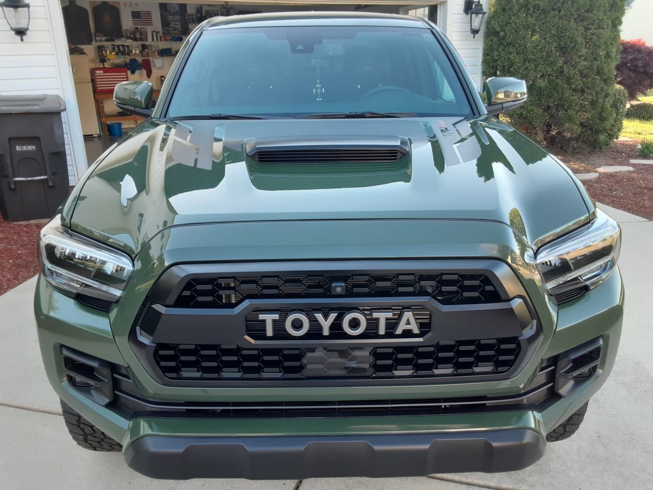

    It looks great! I have only had my 2021 truck for about 4-5 months. I took it to the carwash about 8-9 times, there may be light swirl marks but its hard to tell. do I need to do paint correction? I want to use the cquartz too. Is there another ceramic coating by them besides the 3.0? do you remember which videos were most helpful? TIA

    Stock FOX 275/65/18 At3w 18X9 Fuel Vapor's
    Took this pic today after a quick wax job.
    rimfire7[QUOTED][OP] likes this.
  18. Apr 16, 2021 at 7:50 PM
    #158
    rimfire7
    rimfire7 [OP] I'm here for the tacos
    Dec 13, 2020
    #349474
    794
    beth
    2021 army green taco
    Toytec lift, old man emu springs, Victory 4x4 front bumper and skids, light bar
    very nice! Shinier than my practically brand new one.
    TRD-ED[QUOTED] likes this.
