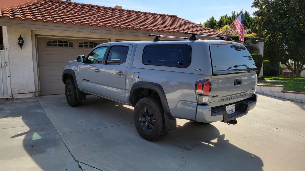

    There are three primary approaches to gaining a higher ride height.
    1) adding a block
    pros: stock ride quality retained
    cons: increased axle wrap
    2) increasing the stiffness of your leaf springs
    pros: load capacity increases
    cons: unloaded ride quality decreases
    2) replacing your leaf springs with those with a bigger arch
    cons: none
    Gen3TacomaOBX likes this.

    It’s all subjective, so I have the opposite opinion. I bought an ‘Ironman Stage2’ kit that came with complete leaf packs for the rear but I sold them on Craigslist and bought single-leaf AAL’s and airbags instead.
    I’ve replaced quite a few complete leaf packs on past trucks and IMO they always ride too stiff-like unless they’re under an increased, 24/7 load.
    My truck’s weight is pretty much stock so the AAL’s I bought gave me a constant lift to match the front end and I still have a reasonably plush ride. The airbags allow me to air-up and tow my trailers as-if I had full, increased-load leaf packs installed.
    For me it’s the best of both worlds.

    I went with the no-cut 3 leaf AAL from Headstrong (you don’t cut the factory shackle off the existing leaves with this AAL) and it gave me 1” of lift over factory height AFTER adding my camper shell (it’s a little over 1.5” of lift without the shell - that’s with the overload leaves removed). I also lifted the front 1”, so I essentially maintained the factory rake but with my shell on, and I’m just sitting an inch higher all around (which was my goal). I regularly load my bed with about 400 lbs. of gear for my work and the rear will sag down about 1”, so I just sit level at that point.
    The ride quality remained unchanged from factory. If there’s a difference, it’s minute. The constant weight of the camper shell I think cancelled out any added stiffness from the AAL. I installed everything last October (so about 8 months ago) and I haven’t seen/felt any change in ride quality or lift height since.
    Sitting unloaded with 265/75/16s…
