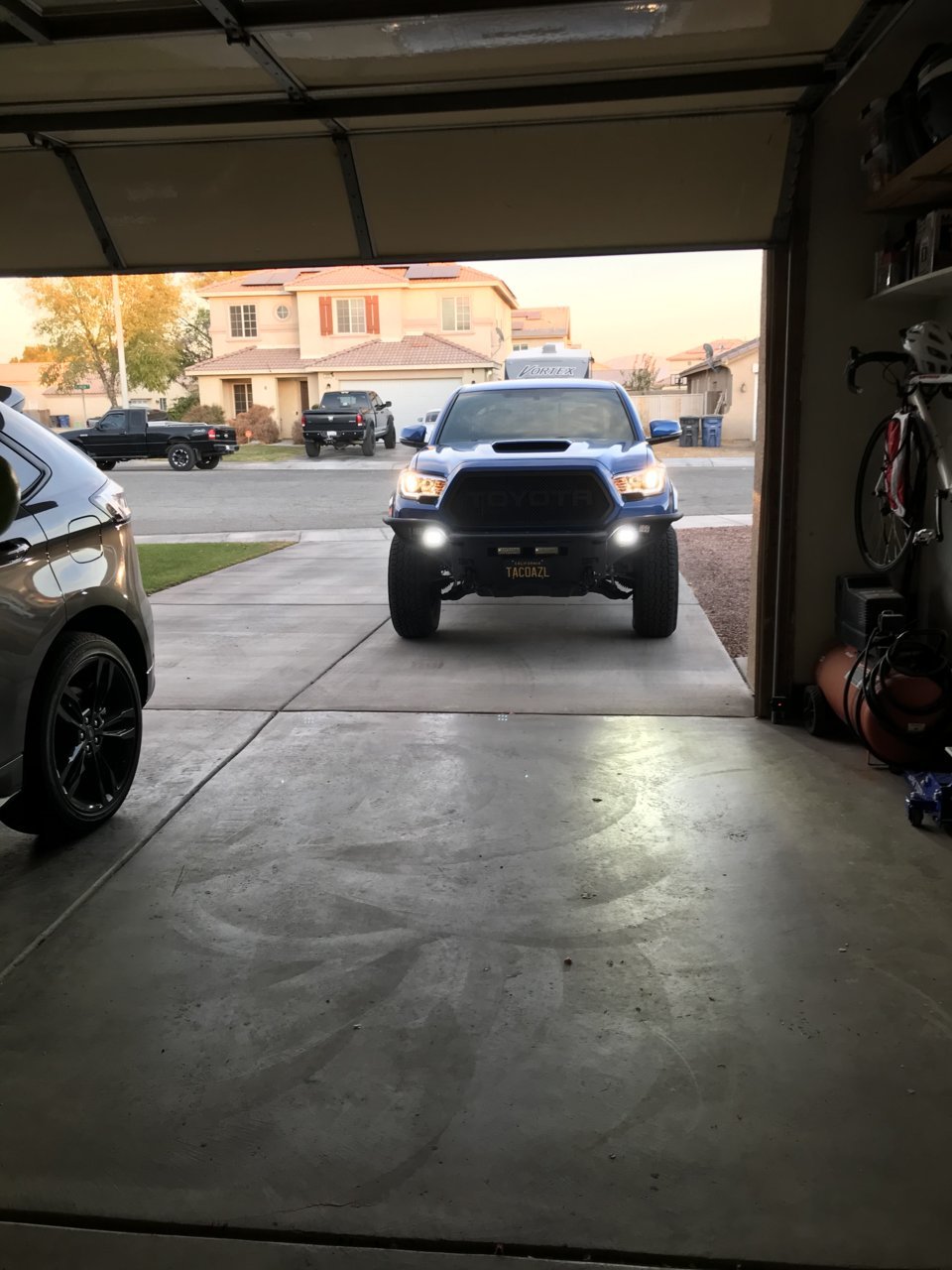

    I use mine to power a set of led cube lights. I use the lights just like fog lights.
