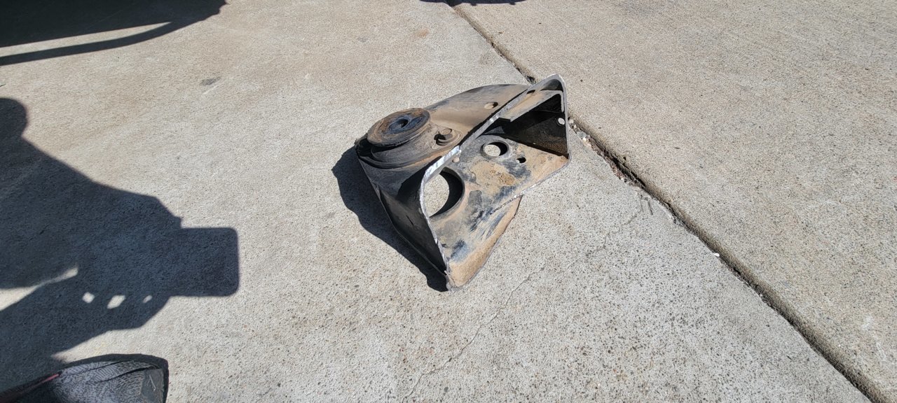

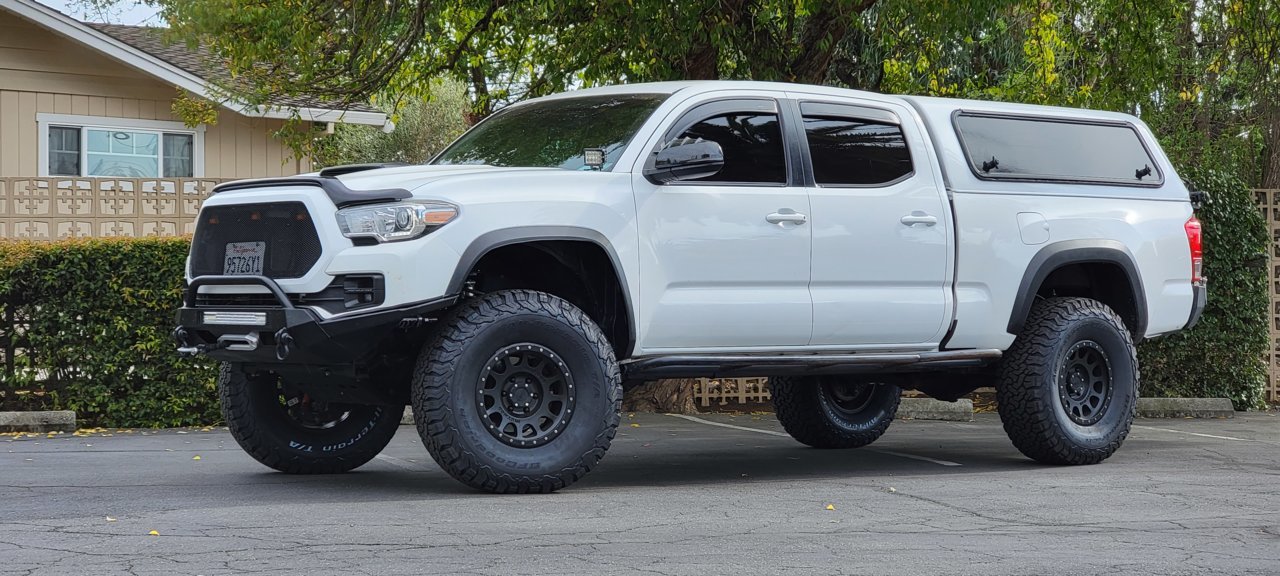

    All of them.
    Cut this off. Remove fender liner. Cut fenders. Beat the firewall back. Cut front bumper if you still have it. And you're still going to rub. Good luck. I just did that size in the past week. 20210410_152942.jpg 20210403_165042.jpg
