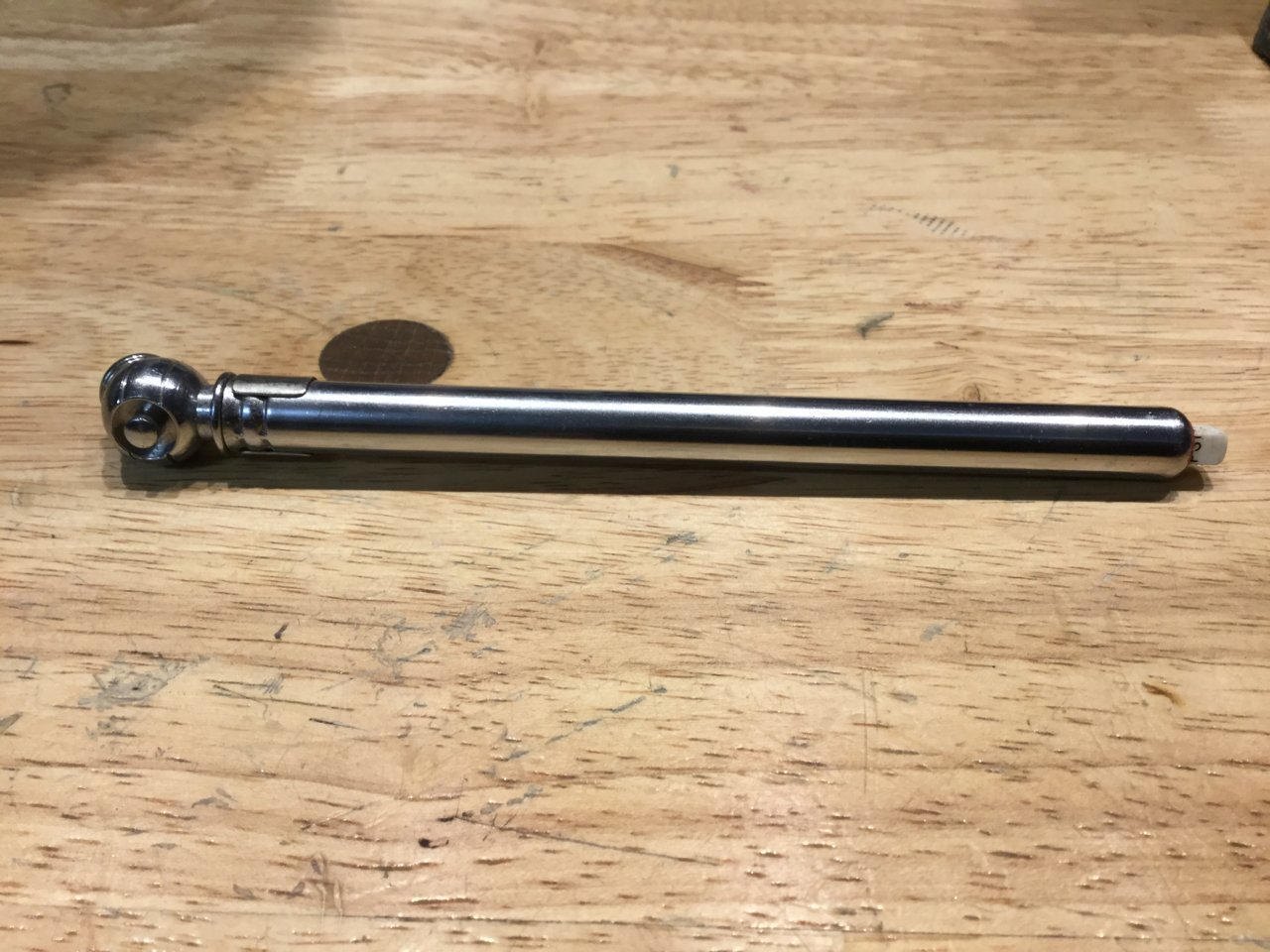

    Your list looks good. I don’t have deflators as my gauge has a simple pin on the head to deflate.
