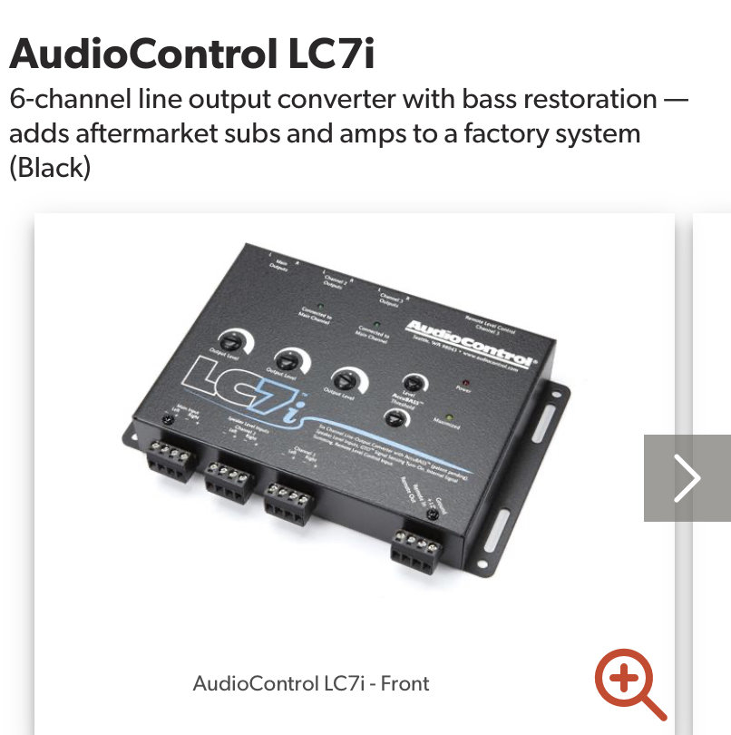

    GOTSAND?18
    GOTSAND?18 Well-Known Member
    Oct 6, 2018
    #268495
    2,233
    2020 tacoma trd off road 4x4 Manual
    stock
    • 8AA85396-E6AF-4AA3-BA2D-8D02D77C527A.jpg Just get one of these use the signal from your speaker wires then u adjust output that goes to your amp .
    mosccat[OP] likes this.
