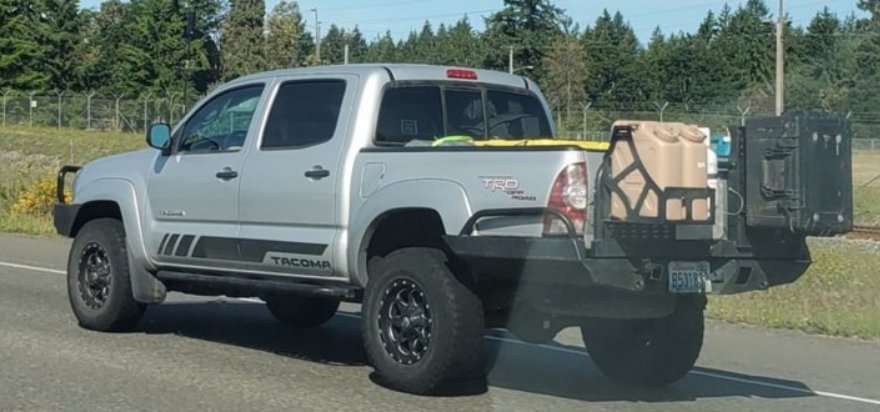

    Now, people know I'm about as far from being the weight police as possible, but I wanted to reiterate how fast weight adds up for choosing your leaf pack. This is my truck at GVWR... I have bumpers front and rear, winch, and sliders. No skids. I'm loaded for camping, including 17 gallons of water at or behind the tailgate. This is far more than 700 pounds, lol, and it doesn't include a RTT.
