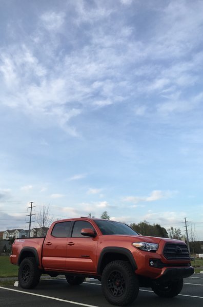

  10. Mar 23, 2016 at 5:20 AM
    #30
    Inferno_Taco
    Inferno_Taco Well-Known Member
    Mar 3, 2016
    #180077
    144
    2015 TRD Pro
    To answer everyone's questions about my truck. All I have are the 5100s adjusted to .85 in the front on the stock TRD springs. I put the matching 5100s on the rear of my truck but did NOT add any lift. I bought a set of 1" lift blocks for the rear but have not put them on since the truck sitting level. I have NO rubbing with this set up.
    Best side profile shot I have at the moment. I'll try to snap a few more.
    Zedek, sdhendo31, CodyX36 and 4 others like this.
  11. Mar 23, 2016 at 10:39 AM
    #31
    eldedo
    eldedo voted most likely eaten by a bear
    Dec 14, 2015
    #172201
    1,820
    Mojave Desert
    '16 DCSBOR 4X4
    2888/5100/Dakars 285's/Camburgs
    what tires are those?
  12. Mar 23, 2016 at 10:53 AM
    #32
    Inferno_Taco
    Mar 3, 2016
    #180077
    144
    2015 TRD Pro
    275/70r17 BFG AT KO2 E Load

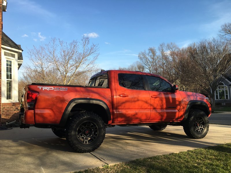

  17. Mar 24, 2016 at 4:42 PM
    #37
    Inferno_Taco
    Mar 3, 2016
    #180077
    144
    2015 TRD Pro
    Better lighting.

  18. Sep 9, 2016 at 6:02 PM
    #38
    PuyallupJon
    PuyallupJon 2020 AG Pro
    Feb 21, 2015
    #149274
    2,247
    Jon
    Puyallup, WA
    2020 Tacoma
    That looks really nice. I have Billies on the way for the front and back. Considering copying you.
