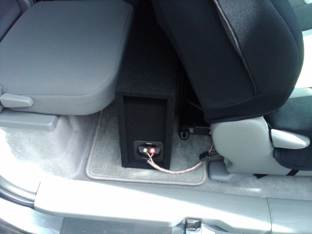

    Yea, that's too cheap for an amp even if you're trying to do things on the cheap. I'm running a an 8" JL sub. Sounds good for a small sub and it's the perfect size to fit behind my passenger seat on the floor and I can still have my rear seat in my access cab folded down. Running it off an older Alpine amp that I reused from an old setup in a previous vehicle. About 300watts RMS and works for me.
