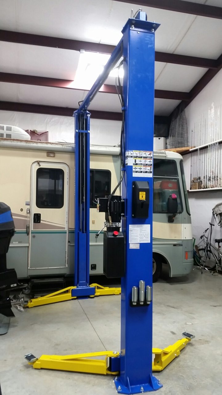

    About $3,400, and 138 inches minimum:
