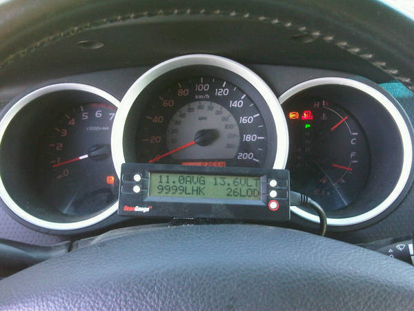

    Hello,
    I've got a combination of dash lights (brake, ABS and slip), and ScanGauge reports no codes. I've been trying to trouble shoot this for a while, so I can't remember what originally set them off.
    There seem to be no normal performance issues, however 4wd does not engage, and the VSC control button is doing nothing.
    I'm assuming it is a sensor issue, however I was hoping someone else has had a similar problem in the past.

    They are likly all linked to the anti lock brake system could have a bad wheel sensor or the control module could be at fault. Disconnect the battery for 10-15 minutes and then check it. You may have to have a dealer put the scanner on it. Odd that you dont have a trouble code.

    Only option. It's normal for VSC to be disabled with ABS and even some CEL codes.

    May be on of the wheel speed sensor got knocked and is out of position, giving these lights.

    You're scan gauge will tell you generic codes from the engine/ECT section of the vehicles ECU. However, it will not scan the VSC/ABS/TRAC ECU. This MUST be scanned by a dealer.

    So I did the scan I and got 8 codes from 3 different places....
    Skid gave me 43, 53, and 98
    ABS gave me 34
    Airbag gave me 35, 37, 55, 55
    Not sure I'm reading your chart right, but does that mean I have:
    1. 43 - malfunction in decel sensor
    2. 52 - ???
    3. 98 - ???
    4. 34 - Left rear speed sensor
    5. 35 - metal stick to speed sensor (FR)
    6. 37 - different diameter tire malfunction
    7. 55 - ???
    8. 56 - ???
    The common component is all those malfunctions is the Brake actuator (ECU control) so I'll start trouble shooting that.
    Alright, found this page: only the ABS code matters, time to troubleshoot my left rear sensor.

    Alright, turns out my left rear speed sensor was loose:facepalm:
    I did the DTC reset (smaked that pedal 8 times with the wire still in, heard everything start to whirrrr)
    But I'm still getting a 43 code from the skid and 34 code from the ABS.
    Is there something else I need to reset, or was to loose wire just the start of my problems?

    Well, at this point I would test all the wires from the speed sensor & deceleration sensor to the brake ecu. If you have good wires then you likely have a bad wheel speed sensor and deceleration sensor.

    wire RL+ was snipped just shy of the sensor.
    Stripped, soldered, shrinked, solved.
