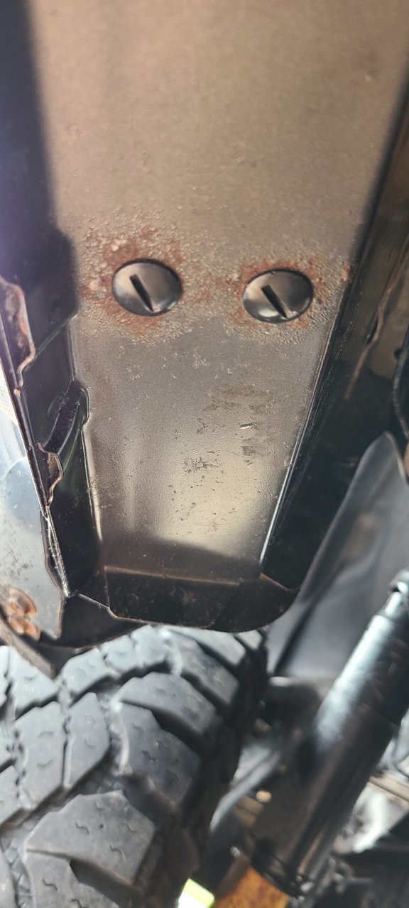

    Was under my truck and noticed these plugs had rust around them. Am I correct in assuming these are plugs or drain holes? The inner caveman in me couldn't resist putting a flathead to one and twisting (so I broke one off). Figured they were coming out anyhow so I can sand this off and paint it. Just trying to figure out a part number and educate myself on the purpose of those holes.

    Screws plugging the threaded holes where running boards mount.

    They rust?

    See the drain channels in the pinch seam at the bottom of the rocker panel? I put the little red tube of the lubricant of my choice up in there and hose up into the rockers at least once per year. I used WD-40 on my old T-100 for years and the rockers and cab corners were solid when I sold it.
    That should get a little lube up in there if you don't want to take them out. Just know that they will drip for a few days.
