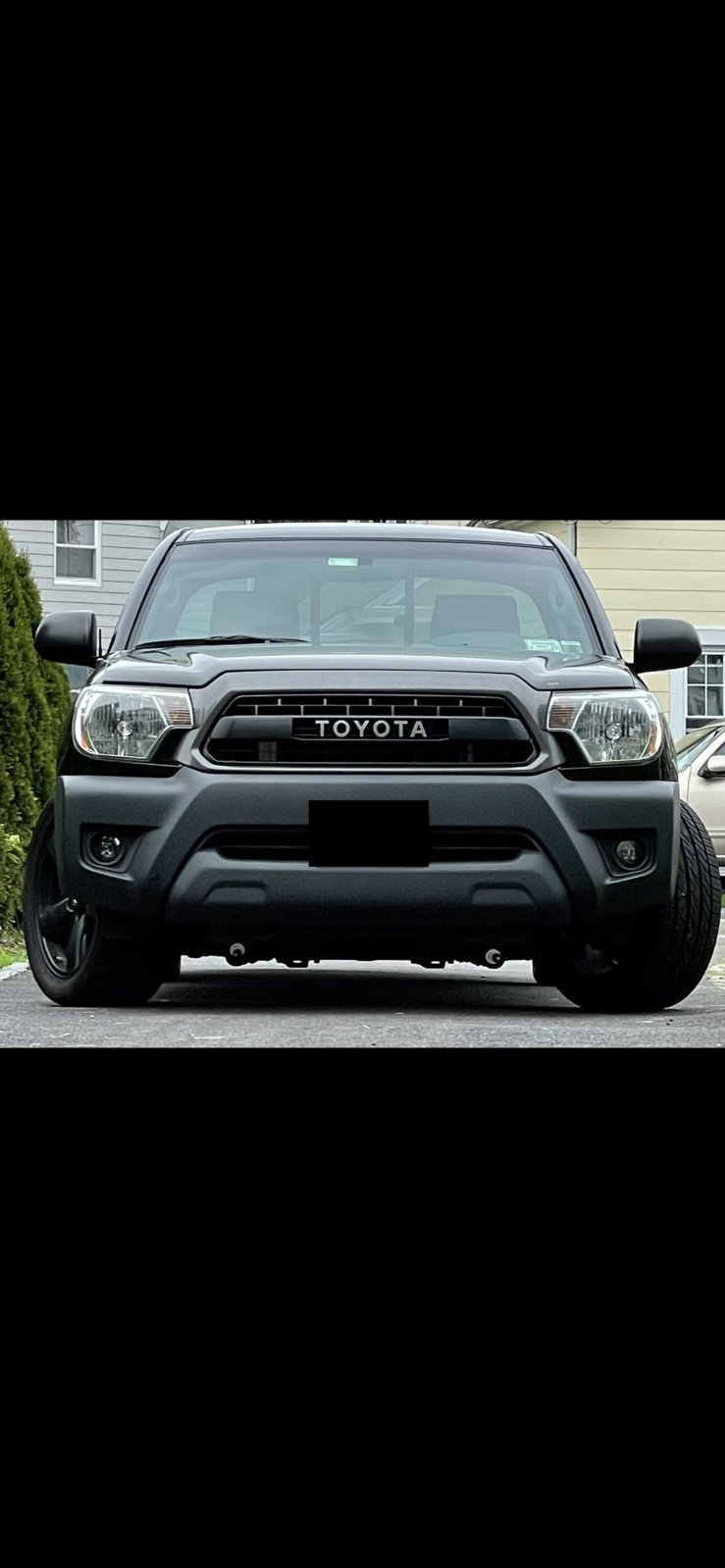

    I already have a lifted 4x4 taco, I want this one to daily while enjoying a little spirited driving

    I just meant the kit in general, control arms etc. I like that every thing stays within spec, so I can get alignment with no issues. Tire size is
    255/45ZR18, I’m running the xrunner wheels
