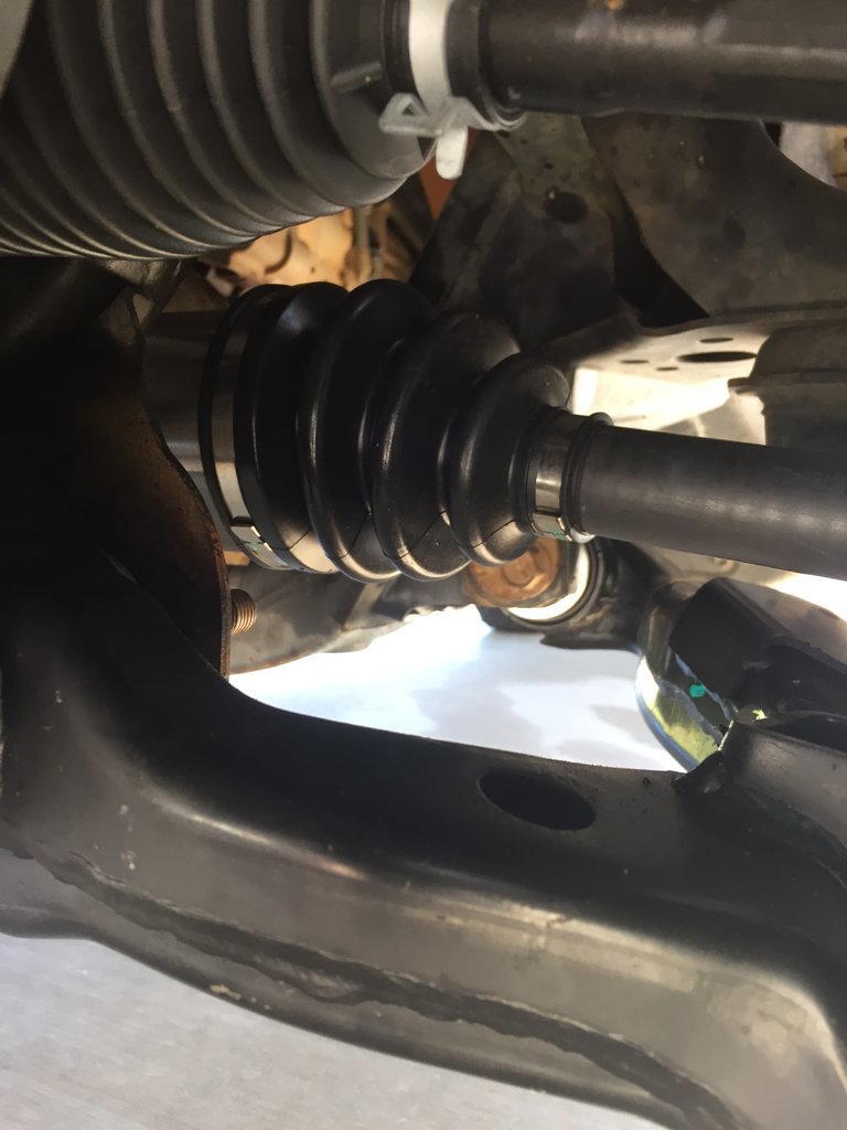

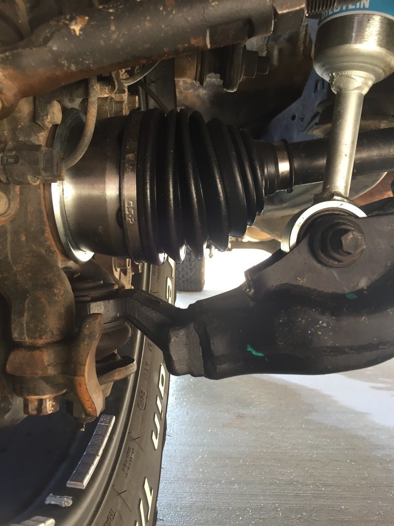

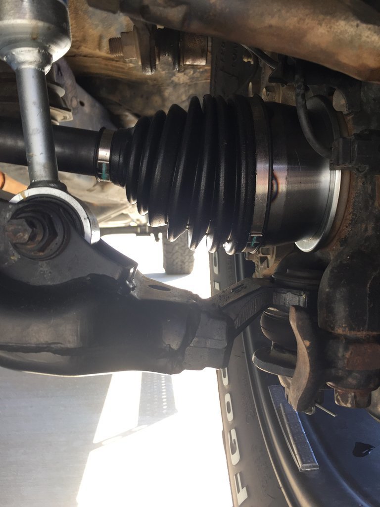

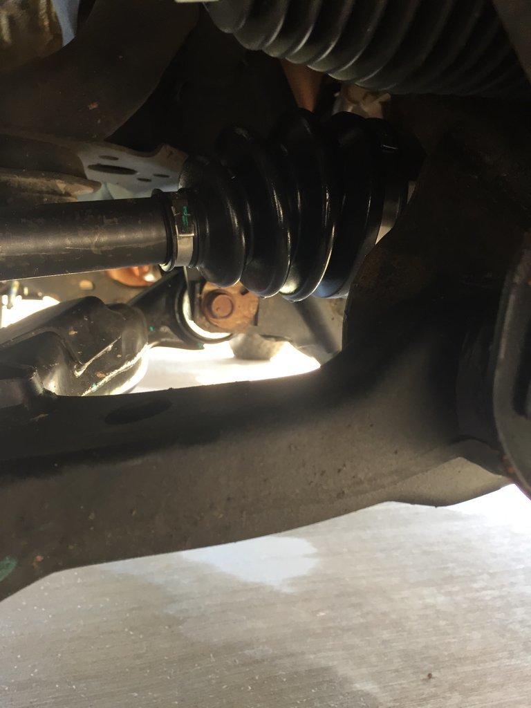

    I've got a 2008 DCLB with 5100s all the way around, OME 885s, and toytec add a leaf in the rear. Method standard wheels and 285/70/17 ko2s. These are my CV angles post lift. What do you guys think? Will this give me any problems?
    Drivers side-
    Passenger side-

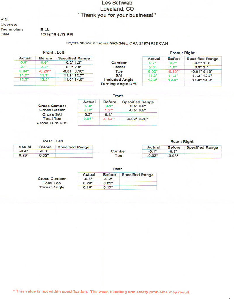

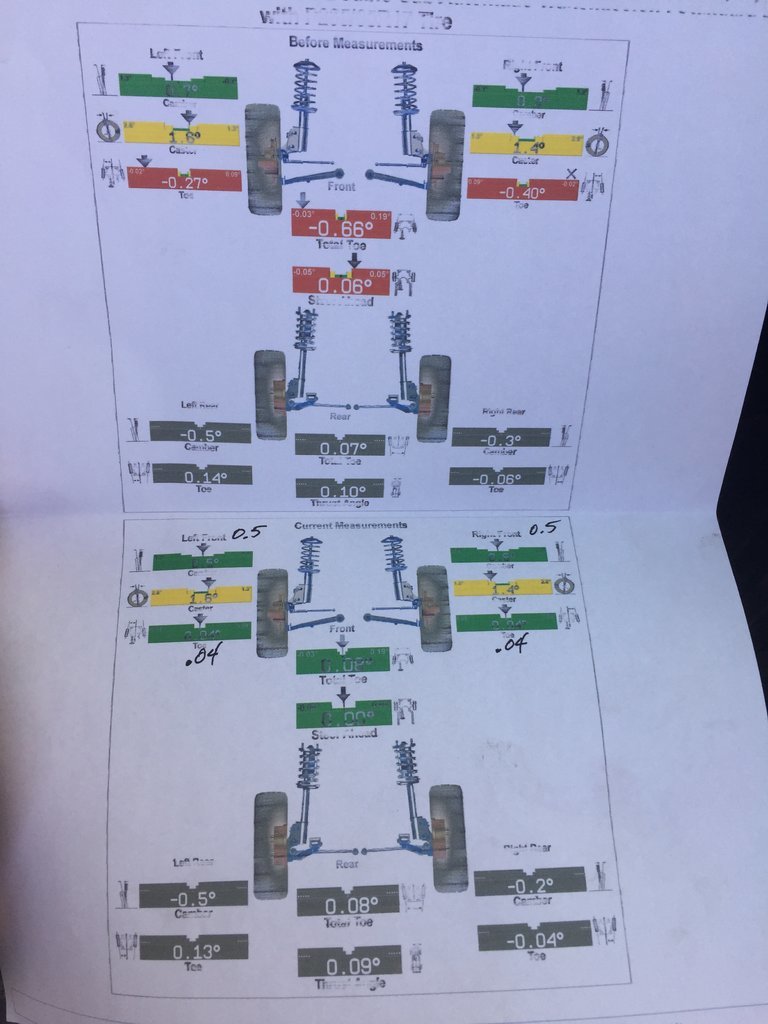

    Also here is a photo of my alignment numbers on stock UCAS. How bad is it?

    Angles dont actually look too bad on the CVs
    But you changed the geometry of the suspension and could be corrected with a propper upper

    The angles don't look bad to me.
    I'd try for better on alignment but ultimately the question is (1) do you wear out tires and (b) is it unstable, wandering, etc.

    My numbers were similar and I had i issues with wear.

    FWIW, I run FOX coil overs and Camburg ball joint type UCA, about 2" of lift. This is post-lift alignment numbers.

    None.
    This was with OME 884s and 1/4" top plate spacers, so essentially an 885 coil and stock UCAs.

    Yeah, I apologize. I was looking at your before numbers. Looks alright to me post-dope slap of myself.
