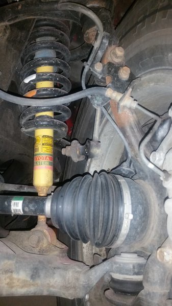

    Hi, I bought a 06 tacoma 4x4 salvage, the truck received an impact in the passenger front wheel. I took my truck to do an alignment but they couldn't do it. The steering wheel is a little bit crooked to the left size.
    What do u guys think I should do to fix the problem.

    Josh, If your saying the truck was hit on the passenger side and the steering wheel moved to the left. The truck took quite a hit. I would bring it to a good body shop and find out what is bent and go from there. Good luck Josh they usually don't total vehicles that are easy to repair......

    take a quick look at the spindle. Note the distance between where the tie rod mounts to the spindle and the distance to the disc brake shield. Its possible one of the spindles is bent (hopefully) otherwise bigger things are bent and messed up.
