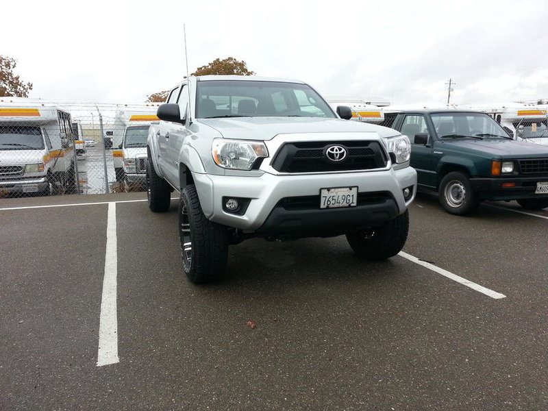

    So the shop put on a Pro comp lift on 3" yesterday. They said everything was perfect what do you guys think.

    Sorry about that... New pics up.

    Does everything look right or do I need uca's.

    Are you using OEM uca's? I like to see camber closer to 0*, and caster around 2.4*

    Yes it is oem. Just wondering should I buy aftermarket?

    When going with a 3" lift, most tend purchase aftermarket uca's to get the caster they want. If you are thinking about aftermarket uca's check out downsouthmotorsports uca's or LR uca's

    alighment looks fine. you are in the green and looks like the guy that did it was smarter then the avg person too as they at least matched the sides. a bit of neg camber is good.

    :thumbsup: IMO. Mo better than the numbers I got and I have adjustable UCAs, but then again the alignment guy had not a F-ing idea what he was doing.

    I think the alignment numbers are pretty good. Very good considering you are on stock uca's. I would take it on the highway and see how well it tracks. I would prefer to see a minimum caster of 2 but if it feels fine...

    Thanks guys. I have about 200 miles on it now. It floats a little bit on the freeway but not to bad. Going back to the shop today to recheck the alignment.
