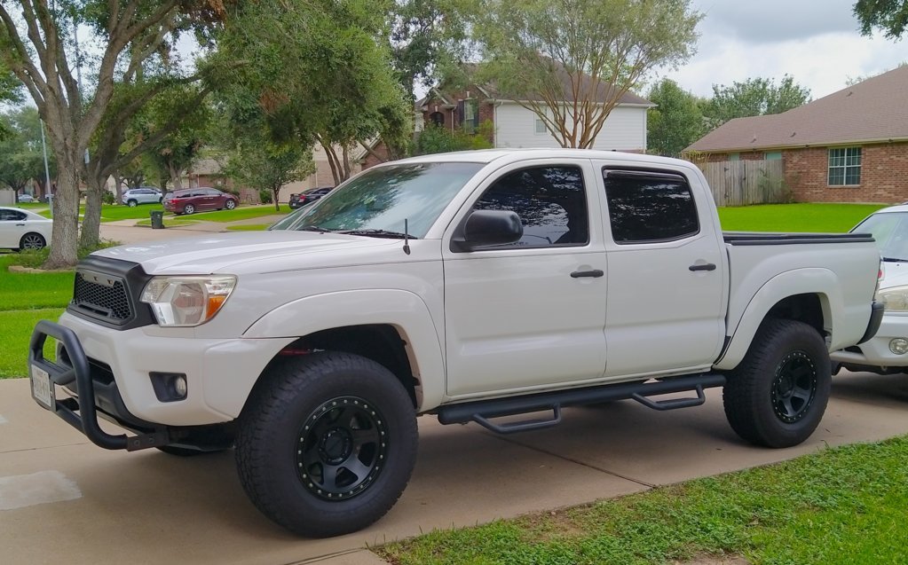

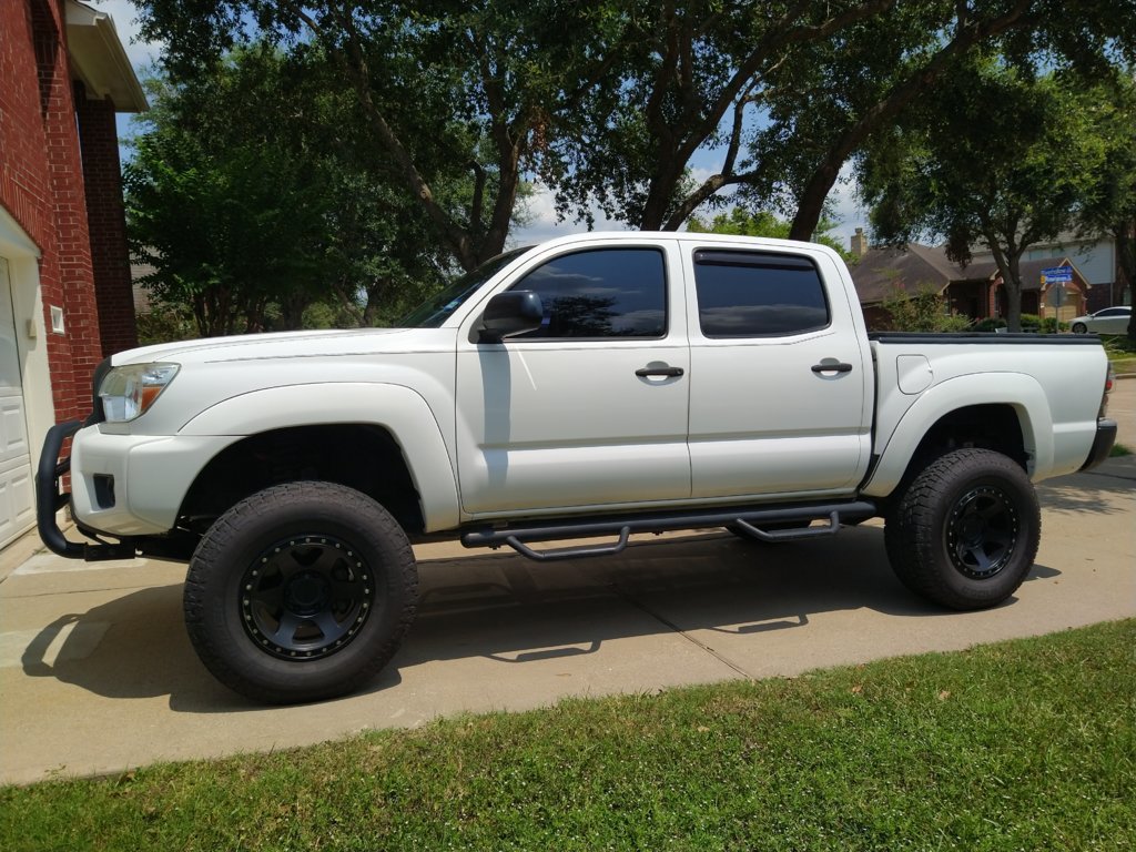

    I removed my lift kit just to see how my Prerunner looks with 1.5 Lift front (Bilstein at 0 with OME 883) and Dakars medium pack with upper overlord removed. 285/70r17 Method 4.50 backspace 0 offset.
    On the other photo she has Maxtrac spindles and Bilstein with OME 883 (5.5) and Dakars medium pack with both overlords and a 2 inch block. I like the 2 different versions of the truck. I think both ways have pros and cons. What do you guys think?IMG_20240915_103929.jpg IMG_20240823_134551.jpg

    I guess it depends on what your use goals are. If you go offroad much, you'll almost certainly want some amount of lift... Where you go offroad should dictate how much lift you need.
    Bigger lift:
    More ground (belly) clearance (good if you get into big rocks much)
    Allows fitting considerably larger tires
    Tends to have worse on-road handling
    Can have worse ride quality (depending on how the lift was executed)
    Fits in fewer parking garages
    Smaller lift:
    Tends to have less impact on on-road handling
    Generally less impact on ride quality (though again it depends on how the lift was done)
    Fits in most garages.
    Allows fitting slightly larger-than-stock tires if you tweak the caster settings
    Less ground clearance
    Anything in regard to looks however is a matter of one's opinion.
    Mine:
    2" lift on 16-17" wheels/32" tires = Good
    5-6" lift on 17" wheels/33-35" tires = Good
    6" lift on 20" or larger wheels poking way out = Bad
    Anything over 7" lift = Bad
    Biggest tires possible stuffed onto a mostly-stock suspension & rubbing = Bad.

    IMO it looks better at 2 in.
    I also don’t like lift blocks on leaf springs. They act like a lever and introduce spring wrap. 2” blocks are modest, so it might not be an issue, except maybe under heavy acceleration. Ever get wheel hop taking off?
    Coil spring spacers are another matter. They don’t affect the parts locating and controlling the front end.
    YMMV:)

    Big lift looks dumb.

    The top picture looks way better to me. If it’s lower, you could get rid of the steps too.

    It's really all up to you, how you drive it, do you care about fuel economy, drive into parking garages much? I've had both and prefer the lower lift and tires. It still looks great and it's just more practical for everyday use.

    Typically when I see big I see junk,cheap or someone that’s never off road.
    There is exceptions for sure.
    I like the 2 inch

    Since it’s a 2wd you are not lifting it for off road but purely for looks. Go with a lower lift. The reason I say that is in general the higher the lift the more problems caused by the lift you may or will experience. Or no lift at all
