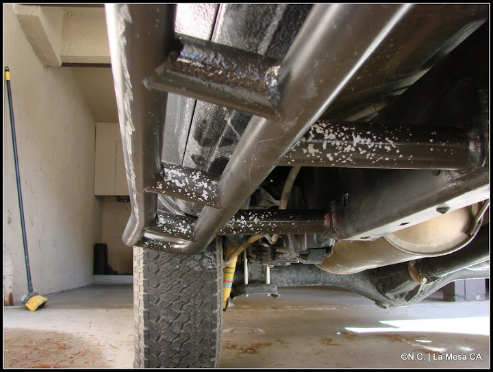

    The sliders will rust if the paint comes off in anyway. My philosophy is that as long as the join welds aren't rusting then some surface rust along the tubes is okay.
    I have to touch up my sliders after major excursions. I'm using Rustoleum hammered.
    What you see in this picture is my slider after a 200 mile excursion through Death Valley. I hauled ass on some gravel roads and I don't have any mudguards and my sliders took a beating. You can see too that there is a major rub on the outside slider from a rock.
    The beauty about repainting them is that it's so easy. Wash them off, dry them, insert cardboard between truck body and sliders and go to town.
    Powder coating makes sense only if the truck is not going to be wheeled offroad.
