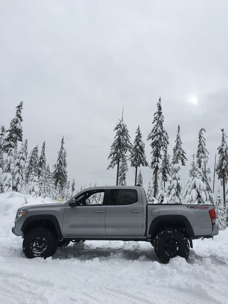

    I welded my sliders on Saturday morning and there was a noticeable improvement in ride quality. UPS man says my ifs and Trans skids will be here Thursday day. If the ride improves more with that 80ish pounds of steel I will leave the preload alone. I decreased front rebound by 2bars as well and that made a pretty nice improvement. IMG_0068.jpg

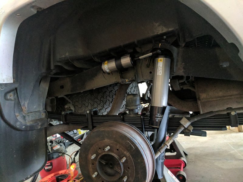

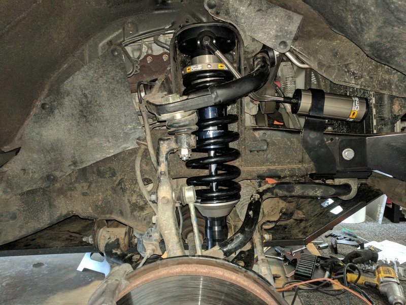

    Installed my OME BP51 setup with full Dakar leaf pack on my 2011 Access Cab 4x4. Front measurements with ARB bumper, front/trans/tcase skids, sliders, aux battery in engine bay. The front BP51 coilovers were left at the factory setting of 20mm preload.
    I have a Leer canopy with Prinsu roof rack and awning installed. The bed is loaded with a sleeping platform, tools and supplies, and the fuel tank is 3/4 full. My guestimate of weight back there on a regular basis is roughly 300lbs. These are my eyeball with a tape measure and straight edge measurements for hub to fender. If anyone knows of an accurate way of measuring this please let me know.
    Front driver side: 22.90"
    Front passenger side: 23.10"
    Rear driver side: 23.90"
    Rear passenger side: 24.20"
    I took my time installing the kit so it took me most of the weekend. I took it out for a spin earlier and I can feel the suspension working much better to support the added weight of my modifications. My previous setup consisting of Bilstein 5100s and Eibach 600lb springs felt like a boat up front with all of the weight. I left the compression and rebound settings where they came from the factory (front: 6 rebound, 4 compression / rear: 3 rebound, 3 compression). I can provide more feedback when I put more miles on the setup.

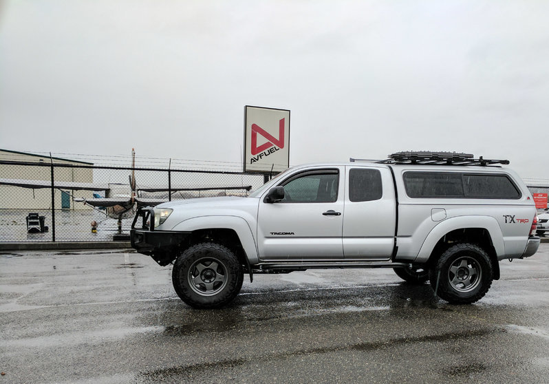

    A quick snap
