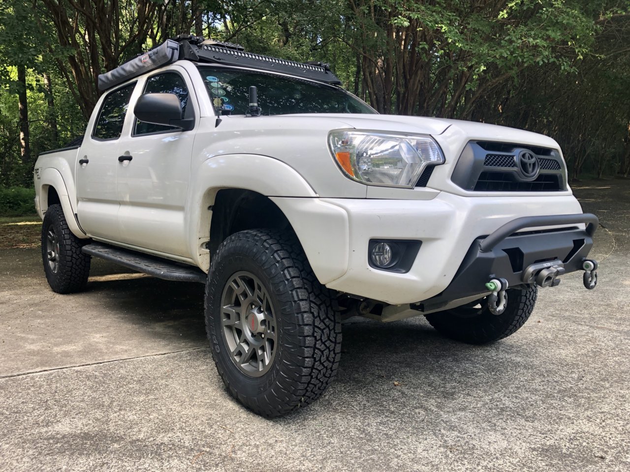

    Reviving an old thread but I’m planning to order BP-51s today. I’m thinking 15mm preload on the passenger side, 17mm on the drivers. Thoughts?
    Alum bumper, synthetic winch line, steel sliders, aluminum skids(full).

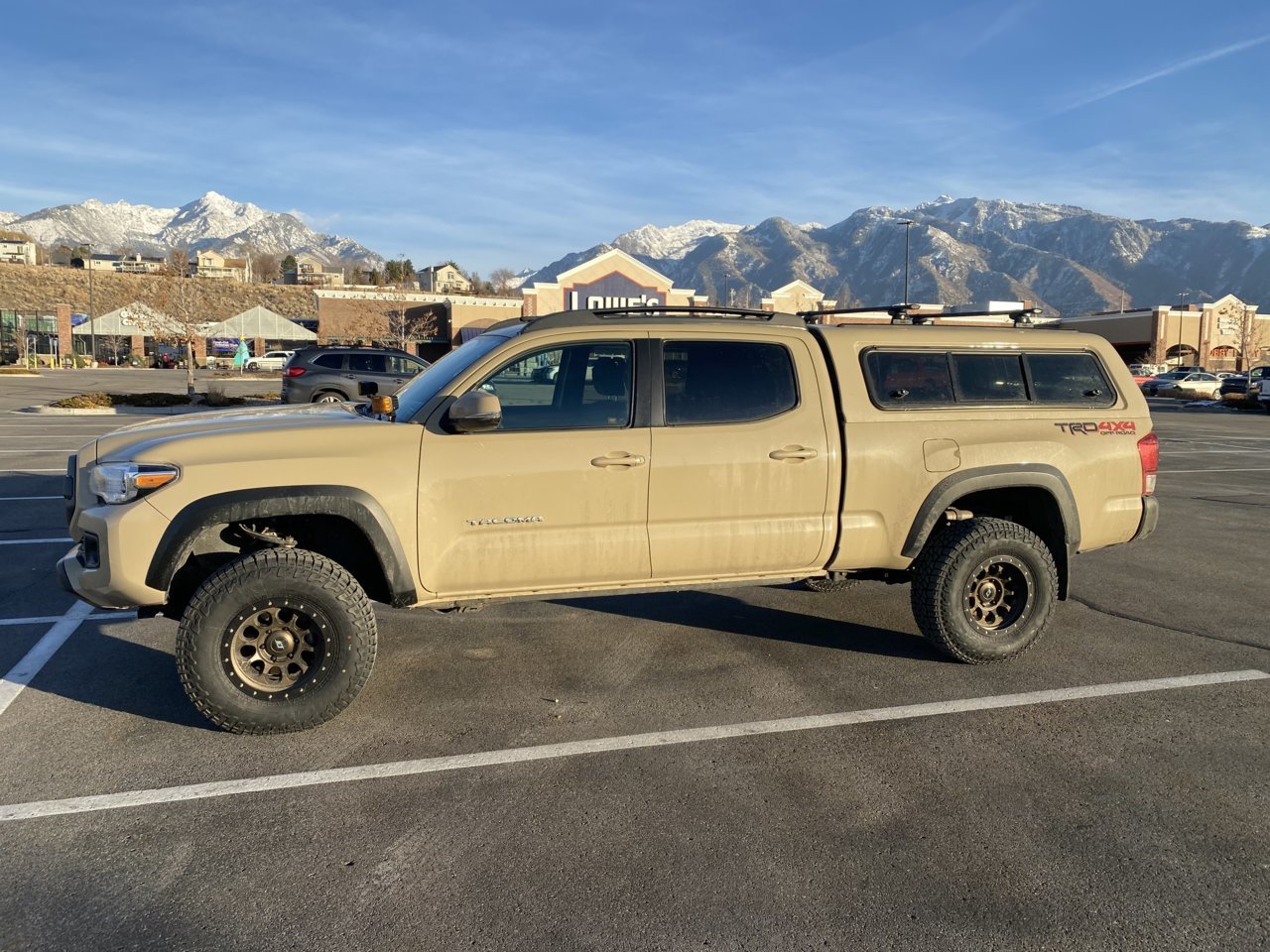

    I’m at 13 driver and 12 passenger with no extra weight. I also have a .5 in spacer on driver and .25 on passenger.

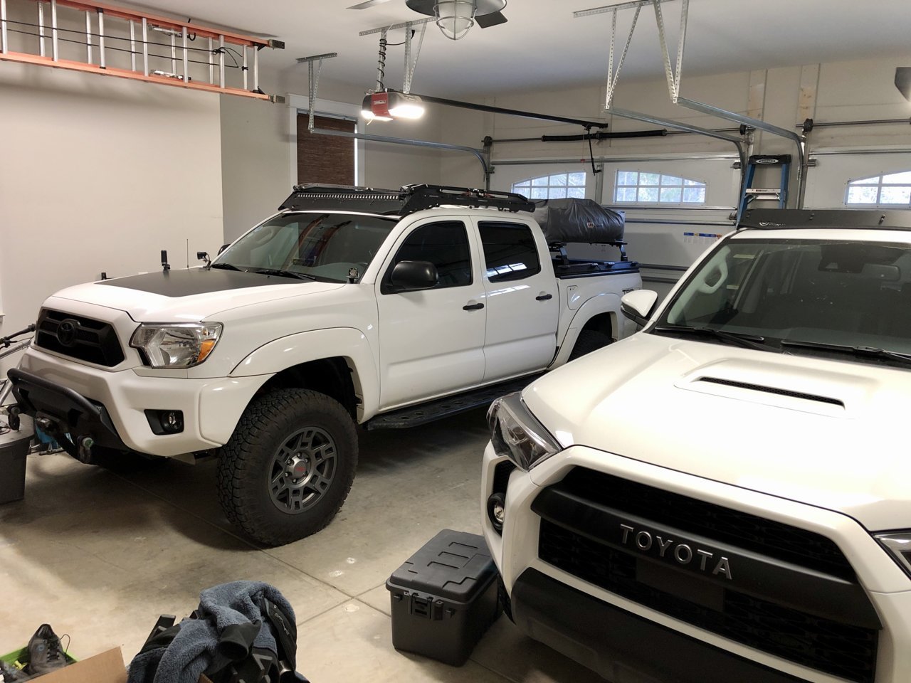

    I doubt that very much. I’m running 886s right now (until my BPs come in a week or two) and they are stiffffffff

    Not enough for 886s, I just got them secondhand from a friend after I added my winch and bumper and the 885s were not quite cutting it.
    Aluminum slimline bumper, winch with synthetic, full aluminum skids and steel sliders.
