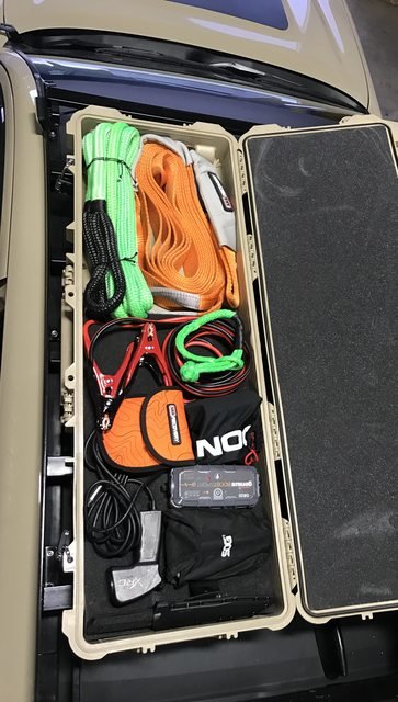

    Tow straps, snatch, winch remote, walkies, light, jumper cables, battery booster, small shovel, med kit, air gauge, etc. basically everything that would be taking up room in the cab

    Thats clean. I like it.

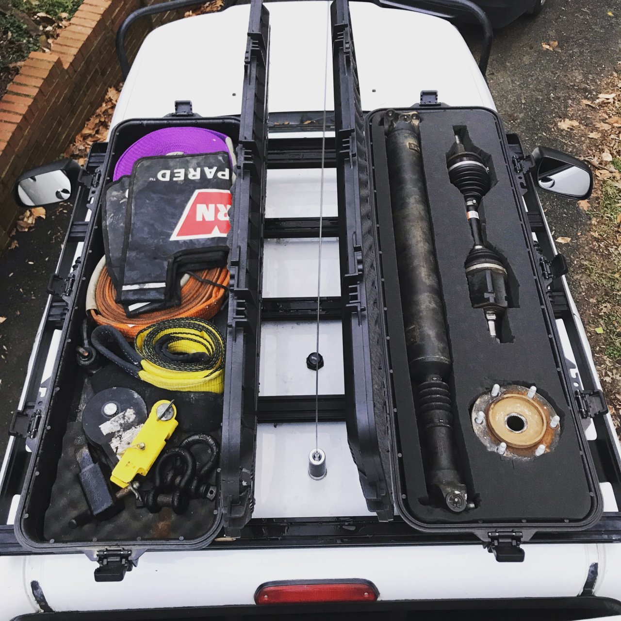

    I want to say it was @EatSleepTacos who carries a spare CV shaft and misc spare parts in one of his, which was also a really nice setup. I could be wrong tho

    Heck yeah it was me.

    Of course man. And here’s how I mounted mine.
    How to mount a Plano on a prinsu
    Materials needed:
    1/4”x1” carriage bolts
    1/4”x1.5” washers
    1/4”-20 nylock nuts
    7/16” socket/wrench
    Drill w/ 5/16” drill bit
    Something to mark where to drill
    T30 bit
    Optional:
    Silicone
    Hacksaw
    Set Plano on prinsu and mark where you want to drill. Just gonna have to eyeball this part
    Drill your holes
    Unbolt one side of crossbar using the T30 bit and set carriage bolts in rails
    Loosely place Plano on bolts, and start the nuts but don’t tighten yet
    Squeeze some silicone under the washer
    Tighten down nuts, add silicone if needed, and trim excess off bolts.

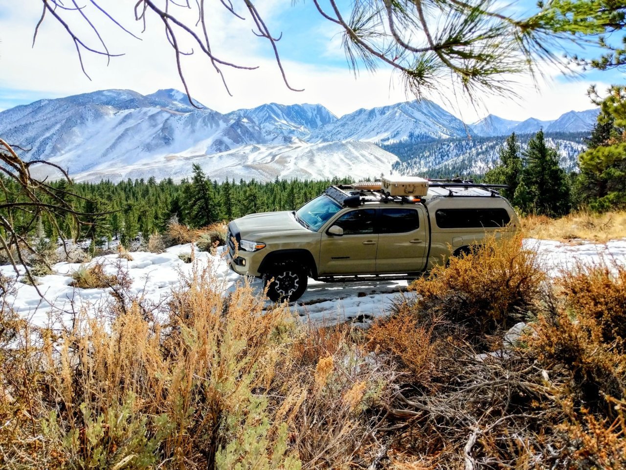

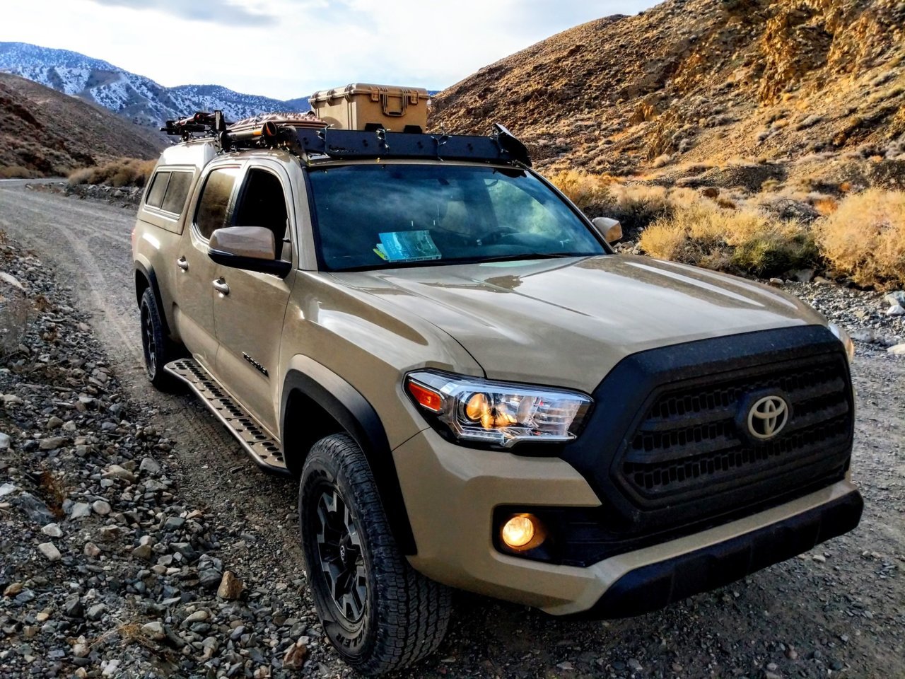

    No pics of the inside yet, but it's all basically just piled in there.
    Here are some pics of it on the truck:
    49587714_10103040513039550_4061802089959915520_o.jpg 49661449_10103040547515460_8119160800028917760_o.jpg 50051946_10103040511687260_2699284746789191680_o.jpg
