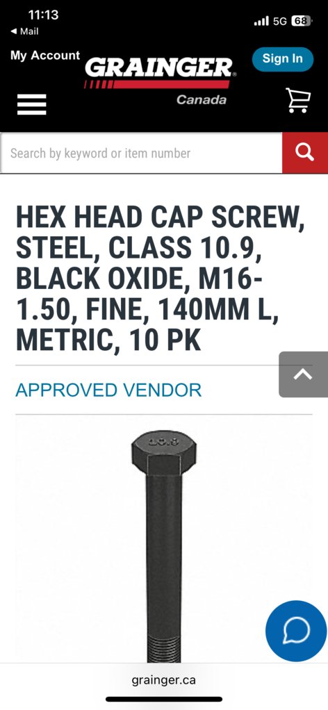

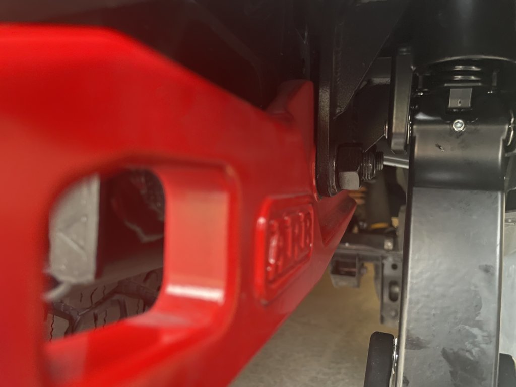

    So was the OEM bolts for the ARB long enough for the nut to be completely threaded on with the SXTH bracket in place or did you replace them with longer bolts?

    The original bolts work, I just did the install last week.

    Nut fully threads on?

    No. Just shy of a couple threads.

    Is there anyone who knows what the bolt size is for the bolt used by Toyota?

    M18-1.5x140mm is what I used on my Trailhunter, this is 10mm longer than stock and leaves a few threads sticking out. Same thread as the stock bolts.

    Thanks

    Does the adapter bracket cause the step to be a little crooked,or you just don't have it tighted up yet...or is it my eye?

    With this setup.I know mine is straight.

    I agree it does look a little crooked
