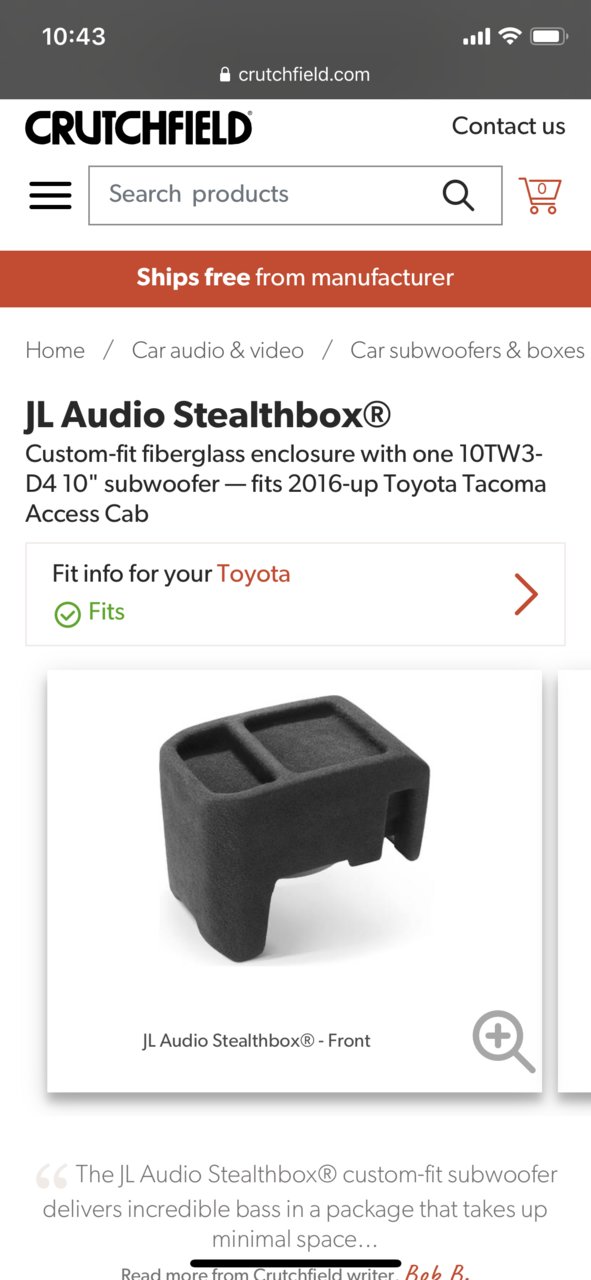

    Here’s the box I’m going to use:
    I may be trying to solve problems before I have them with this. I do that sometimes. The wiring harness finally arrived today and the last of my wiring should be arriving Friday (NOBODY around me had ANY wiring! I had to order it all online) so I can put the amp and box in this weekend and we’ll see how awful the rattles are before I start spraying foam around. If I do use spray foam. I’ve heard of people using it in doors for sound deadening so I figured it would be an easy way to take up the irregular space under the plastic tray that sits in the trough under the jump seats... I’ll keep you posted

    Definitely looks like an awesome setup! It looks like a great solution for the sub— I was going to go with an under seat powered sub, but it seems most people are underwhelmed by them. Your system should sound way better. Do you mind telling me how you’re installing your line-out converter for your amp? I was going to splice into my factory wiring because I couldn’t find a harness for the 2020 head unit. Were you able to find a better solution?
