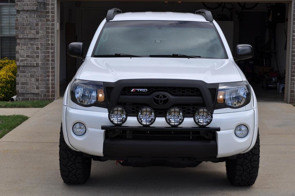

    I like the way it looks as it sits but that's just me. I thought about running LED's but decided against it in the end after I did some research.
    I've got the exact BLHM as you with the exception of the lens over the DTRL.
    This Picture was taken with a clear silverstar bulb. I have since put the factory amber back in and I love how it looks now (I'll try to get a picture later today).

    You mean it's better with the amber DTRL than the white?

    I personally think so. I'll let you be the judge. I should have taken the picture of the truck outside of the garage but it is sunny as shit here today and I was afraid it wouldn't turn out right.
    It looks cool as shit running down the road though.

    I have to agree, especially with the BHLM, because the white on this mod is too light
