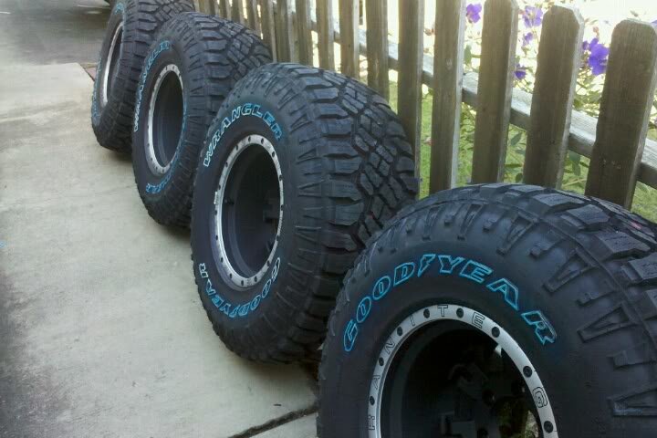

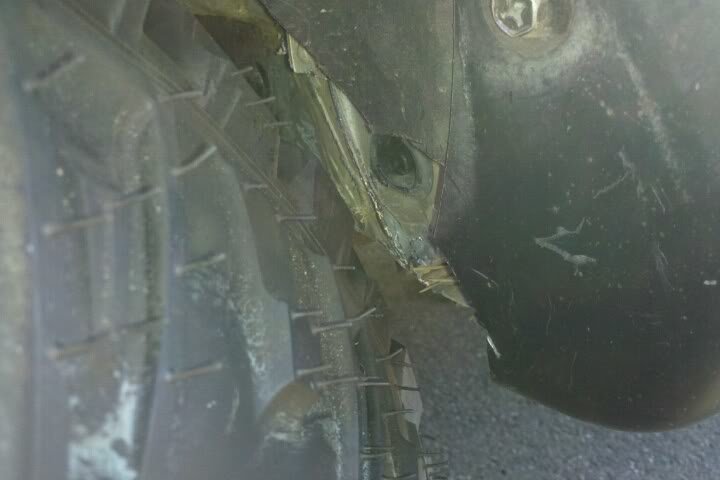

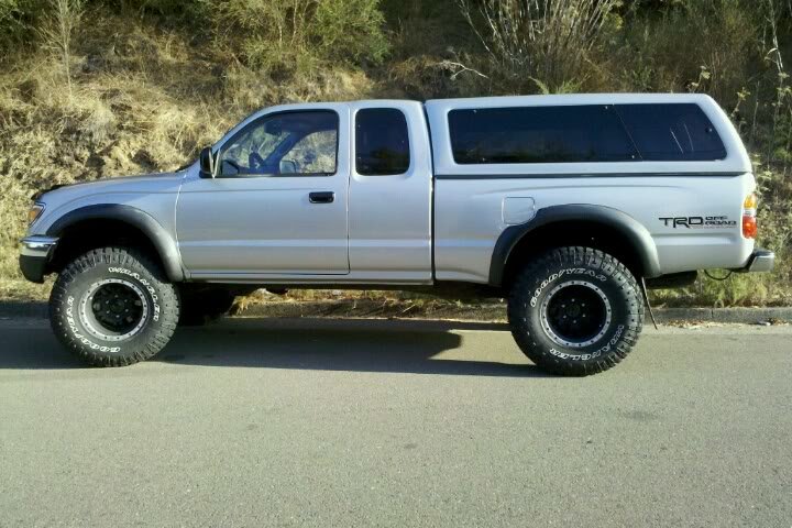

    Well i have 15x10's on 33x12.5's on a 4x4 with a 3' lift and i had miner cutting to the pinch weld and no rubbing a full lock.
    As you can see in the image below there is about 1" clearance at full lock
    These tires are monsters and they fit like a glove.
    Personally i think 15's look better on a 1st Gen then 16's IMO and 16's for a 2nd Gen
