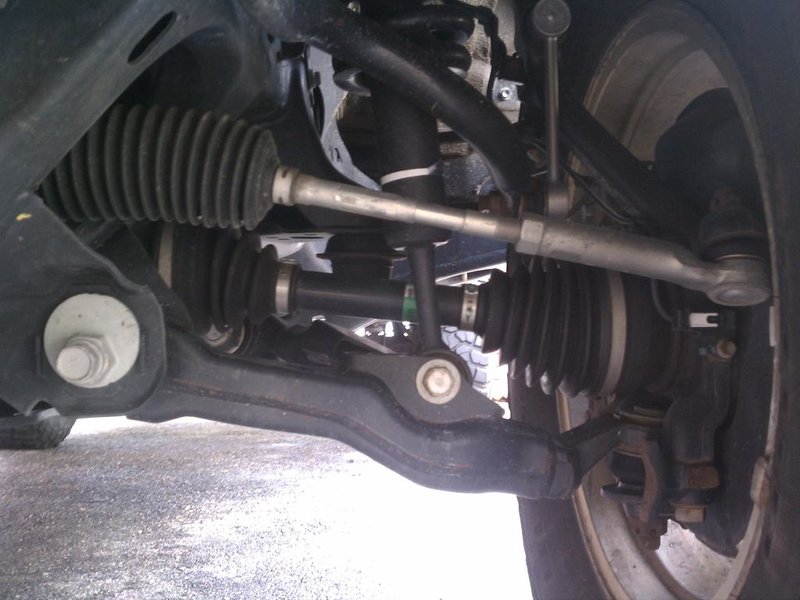

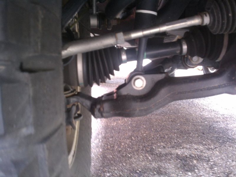

    how the F were you at 4.5" of lift? are you CV's not binding up? pics of the front suspension?

    i dont have any of the front, but they seem to be fine. no binding.

    First off----- Awesome looking truck. :) Secondly----- Your CV boots will wear and leak in a few short miles and your CV's will take a little longer but they will fail also. I wish it wasn't the case but you're past the limit of the angles these CV's will take. :eek:

    here are some pics of my cv angles dude, tell me what you think. I have a diff drop kit that ive yet to put in, but after readin alot of threads on here idk that i will put it in. i do get some vibes from the driveshaft, and i have 4 degree shims in right now. what im going to do is, i have a set of 2 degree shims, im going to put them in backwards to shim the driveshaft down so it is more parallel with the the tranny and the two angles will cancel themselves out since that is how a driveshaft with u joints is supposed to be. hopefully that will clear up most of the vibes, but even the ones i have now are BARELY noticable from 1-3mph... and 20-25mph. i can live with them if they dont go away, just would like to try some different stuff to see what happens.
