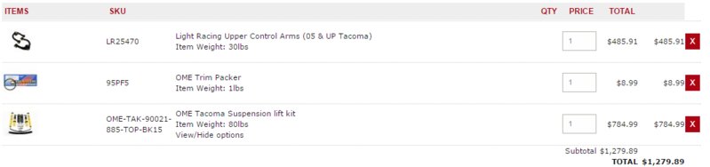

    This is my setup currently before hitting checkout:
    90021 Shocks
    885s - (I am open to input on the coils)
    trim packer for drivers lean
    LR UCAs - do these come with all required hardware?
    I'm going to run the top-plate spacers for the full 3"
    Also going to run the 1.5 inch block setup instead of leafs.
    I have some 17x8.5 SCS Sr8 (jet black) on stand by
    w/ 285/70r17 BF Goodrich AT KO2
    Looking for any input, advice, or even pictures from any users running this setup or who can effectively contribute to this thread.
    Thanks guys!

    you think i should swap for the Dakar pack even if im not really hauling anything?

    X2 blocks suck most of the time and with our soft stock leaf springs you'll have more issues down the road. do it once and do it right.

    I would go AAL over blocks if your budget doesn't allow new springs.
