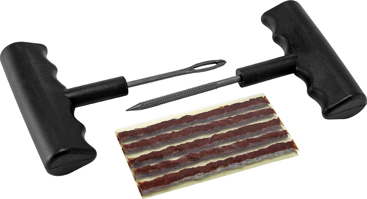

    I use these… never an issue. Just don’t use them in motorcycle tires…those are replaced if punctured. 25F39020-A232-472D-A71A-FBC30B87516D.jpg
