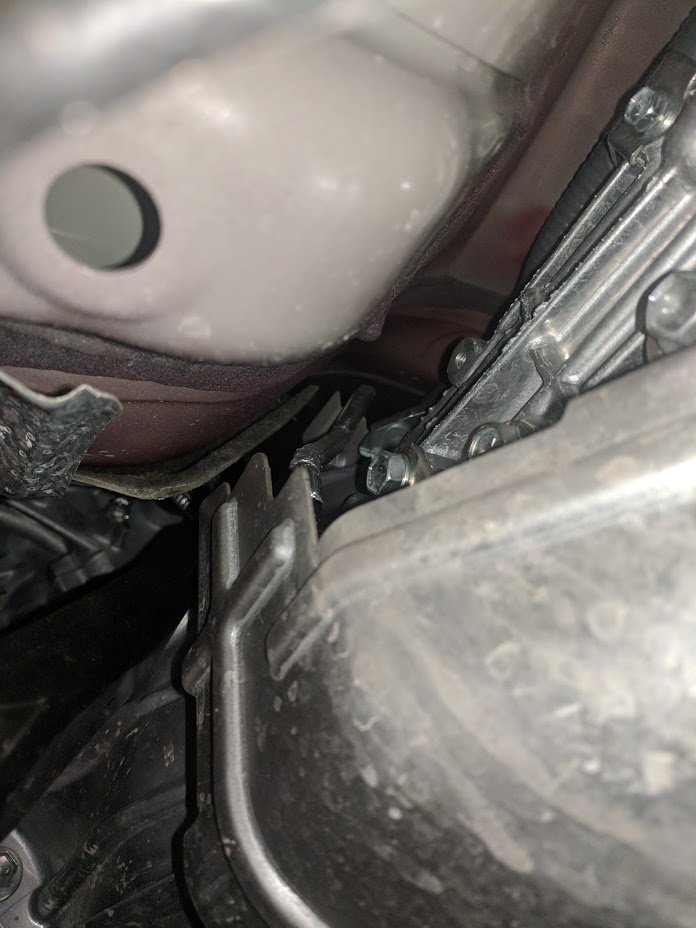

    The accumulator and slave are on the left side of the transmission case, away from the drive shaft.
    I forgot to snap a pic when I had the heat shield off and was measuring:

    The accumulator is not a just a coupling. I think is has some kind of expansion system on the inside. I don't know if it is a diaphragm, ball spring, or whatever and don't think a drill would fix it.
