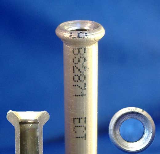

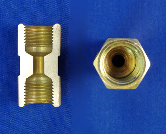

    I think the explanation is correct but I think it's important to make a description distinction. What Toyota typically uses is correctly (I believe) called an Inverted Double Flare and not a Bubble, which is usually what the ISO/Euro (sometimes DIN, which may not be right) flare is called.
    But it's not always the case, the question has come up because Bosch made ABS modules for Land Cruisers at some point and the fittings on that end of the lines were typical of European cars, e.g. the ISO/DIN Bubble and the rest of the brakes used SAE/Japanese Inverted Double.
    The key is the female fitting will have a cone sticking up inside and not a cavity. The flare is sandwiched between two cones on Double Flare while the tube on Bubble is flat on back and seats against a concave cone.
    Taken from IH8MUD: https://forum.ih8mud.com/threads/question-about-brake-line-fittings-cutting-and-flaring.779567/
    Double Flare on left and Bubble Flare on right.
    Again, Double Flare on left, Bubble Flare on right.
    Taken from: http://www.fedhillusa.com/?page=flare
    In this case Double Flare tube end.
    Looking inside the female fitting for a Double Flare.
    This is Bubble Flare.
    Looking inside a female fitting with Bubble Flare.
    And BTW, the NAPA coupler most people get is correct, inverted double. Only pointing out that "bubble" may be confusing.
    https://www.napaonline.com/p/BK_6415027
    A fairly easy comparison of "Double" vs "Bubble".
    https://www.hoseandfittingsetc.com/our-blog/bid/76614/Brake-Line-Fitting-Identification-How-to
