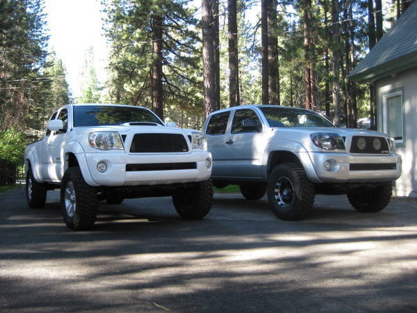

    my sister has TC spindles on her 05 tacoma. she really likes them, says the ride is a lot better. the only complaint she has is that the stock 17s on the 05 don't fit with them so she had to get wheel spacers and her alignment is way off. since you have an 02 i don't know if you would have the same problem...
    if what you want is the front end higher, you will definitely get that. her tacoma has a pretty big lean to it. these pictures aren't good and you can't really tell, but hers is the white one.

    Wow..sisters with Tacomas..never heard such a thing!
    edit: do you have any side views of the white Tacoma?

    ^ That is a fat lean...does she have any sort of lift in the rear?

    nope not yet, she's planning on dakars in the rear i believe.

    im not a big fan of the front tires sticking out so far and the back ones tucked in.... just doesnt look right, two very nice trucks though

    the only reason her front tires stick out so much is because she had to get wheel spacers for the stock wheels to fit with the new spindles. i don't like it either.
